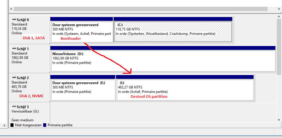

  4. Configure 2 Disks, Nvme and Sata3 in Windows 10
    Use bootloader from a SATA disk to boot Windows installation on a NVME disk
    I want to move my Windows 10 installation to a new NVME disk (disk 2). I have cloned the original SATA disk (disk 1) to the NVME disk. Unfortunately I have an older motherboard (ASRock H77 Pro4/MVP) that does not support booting the NVME drive directly.
    Both disks are using a MBR, have a 'system reserved' partition and a partition holding the OS. If I understand correctly, the system reserved partition contains the Windows bootloader. Windows seems to be handling the NVME drive just fine. Is it possible use
    the bootloader and the 'system reserved' partition from disk 1 and have it start the OS from disk 2?

    I have tried adding the OS on disk 2 as an alternative boot entry using EasyBCD. This restulted in the following BCD configuration:
    Code:
    Windows Boot Manager
    identifier              {9dea862c-5cdd-4e70-acc1-f32b344d4795}
    device                  partition=\Device\HarddiskVolume3
    description             Windows Boot Manager
    locale                  nl-NL
    inherit                 {7ea2e1ac-2e61-4728-aaa3-896d9d0a9f0e}
    default                 {868eec41-5821-11e8-a835-e2488662881a}
    resumeobject            {868eec40-5821-11e8-a835-e2488662881a}
    displayorder            {868eec41-5821-11e8-a835-e2488662881a}
                            {44fda4da-5819-11e8-a499-c54e35723be3}
    toolsdisplayorder       {b2721d73-1db4-4c62-bf78-c548a880142d}
    timeout                 30
    Windows Boot Loader
    identifier              {868eec41-5821-11e8-a835-e2488662881a}
    device                  partition=C:
    path                    \WINDOWS\system32\winload.exe
    description             Windows 10
    locale                  nl-NL
    inherit                 {6efb52bf-1766-41db-a6b3-0ee5eff72bd7}
    recoverysequence        {44fda4d8-5819-11e8-a499-c54e35723be3}
    displaymessageoverride  StartupRepair
    recoveryenabled         Yes
    allowedinmemorysettings 0x15000075
    osdevice                partition=C:
    systemroot              \WINDOWS
    nx                      OptIn
    bootmenupolicy          Standard
    hypervisorlaunchtype    Auto
    Windows Boot Loader
    identifier              {44fda4da-5819-11e8-a499-c54e35723be3}
    device                  partition=I:
    path                    \Windows\system32\winload.exe
    description             Windows NVME
    locale                  nl-NL
    osdevice                partition=I:
    systemroot              \Windows
    This does not seem to work. When booting the second option, the systems complaints about '\Windows\system32\winload.exe'.
    Any ideas on how to get this working? Should the Windows bootloader be able to access the NVME drive? Is there something wrong with the BCD configuration? Can this be achieved using an alternative bootloader?
