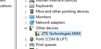

    Hello Team,
    I have airtel 4g dongle and its not connecting with my company's laptop(domain machine). Showing attached error in device manager.Same dongle is working fine with another machine which is in same domain and my personal laptop as well.USB storage and and
    other USB devices are working fine.Even another model of airtel dongle works fine. Kindly suggest.
    OS Version :-Windows 10 enterprises 64 bit Version 1809(OS Build 17763.1282)
    Airtel Data Card Model:-MF833T

  4. Connecting airtel dongle to windows 10
    My Airtel 4G dongle is not working on windows 10 v1703
    I had same issue where airtel 4G dongle was connecting , but not able to reach internet. Changed multiple firewall settings for windows 10, but no luck. At last, changed options from RAS to NDIS in dongle GUI and it started working all of a sudden !!
    Thank you for the simple but awesome solution..
