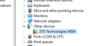

    Hello Team,
    I have airtel 4g dongle and its not connecting with my company's laptop(domain machine). Showing attached error in device manager.Same dongle is working fine with another machine which is in same domain and my personal laptop as well.USB storage and and
    other USB devices are working fine.Even another model of airtel dongle works fine. Kindly suggest.
    OS Version :-Windows 10 enterprises 64 bit Version 1809(OS Build 17763.1282)
    Airtel Data Card Model:-MF833T
    Connecting airtel dongle to windows 10 d3aa5d2b-676c-41b5-8ee3-c016248d2fcd?upload=true.png
    Nishant Bhoir, Jan 12, 2022
