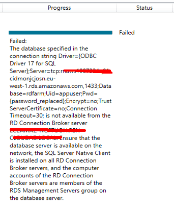

    I'm having troubles configuring RD Connection Broker High Availability on Windows Server 2016.
    The initial setup on the first Connection Broker worked well, using a shared database server configuration.
    However, if I'm now trying to add the second Connection, I receive the error message down below. When setting up an ODBC data source on the affected Connection Broker server, using the very same settings from the Connection String I used in the HA-Setup, the connection to the SQL Server and database works just fine, so it's neither a connectivity/firewall issue, nor authorization issue.
    Any I idea what I might missing?
    Thanks,
    Harald
