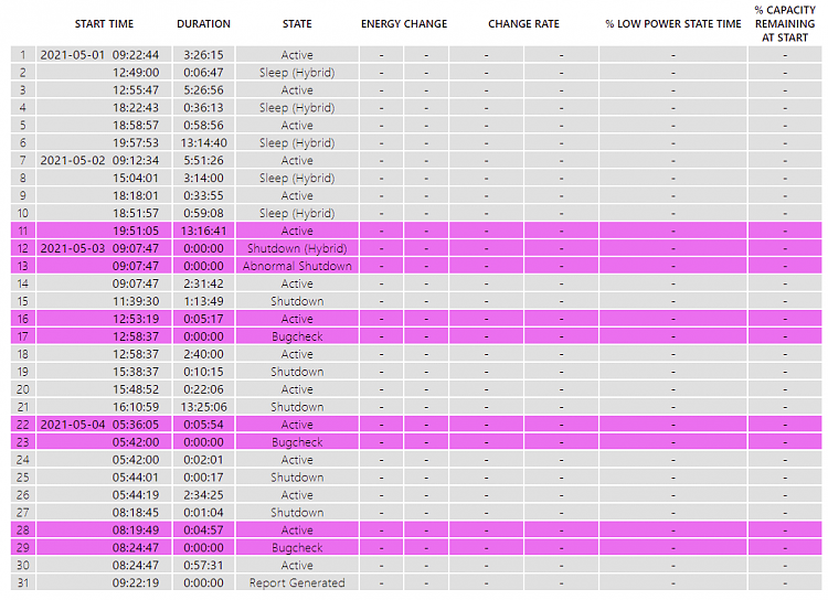

    The pattern of crashes is summarised below from the Power report:
    Constant crashing blues screens and powering off 331323d1620204099t-constant-blue-screens-lately-when-used-when-idle-image.png

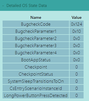

    Each bugcheck is the same and is a hardware error:
    Constant crashing blues screens and powering off 331324d1620204182t-constant-blue-screens-lately-when-used-when-idle-image.png
    This is quite a rare one but I have seen an increased number of these in recent weeks. I am not sure what is causing it but I would certainly recommend making Microsoft aware of it via Feedback Hub.
    You could try different power plans to see if they make any difference. You are currently using a high performance power plan and I would try the balanced one.
