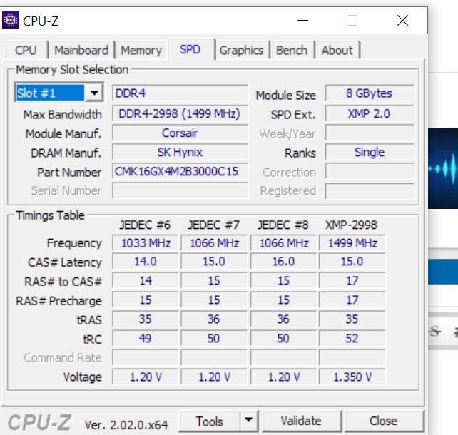

    Hi Yes all the sticks are the same brand it reverts to 2133mhz when xmp is off Here is the ram info they are all the same
    Corrected hardware error has occured 378267d1667318387t-corrected-hardware-error-has-occurred-capture.jpg
    - - - Updated - - - what would be your opinion if the errors are not causing a slow down or bsod would it be safe to leave on the xmp for 3000mhz.
