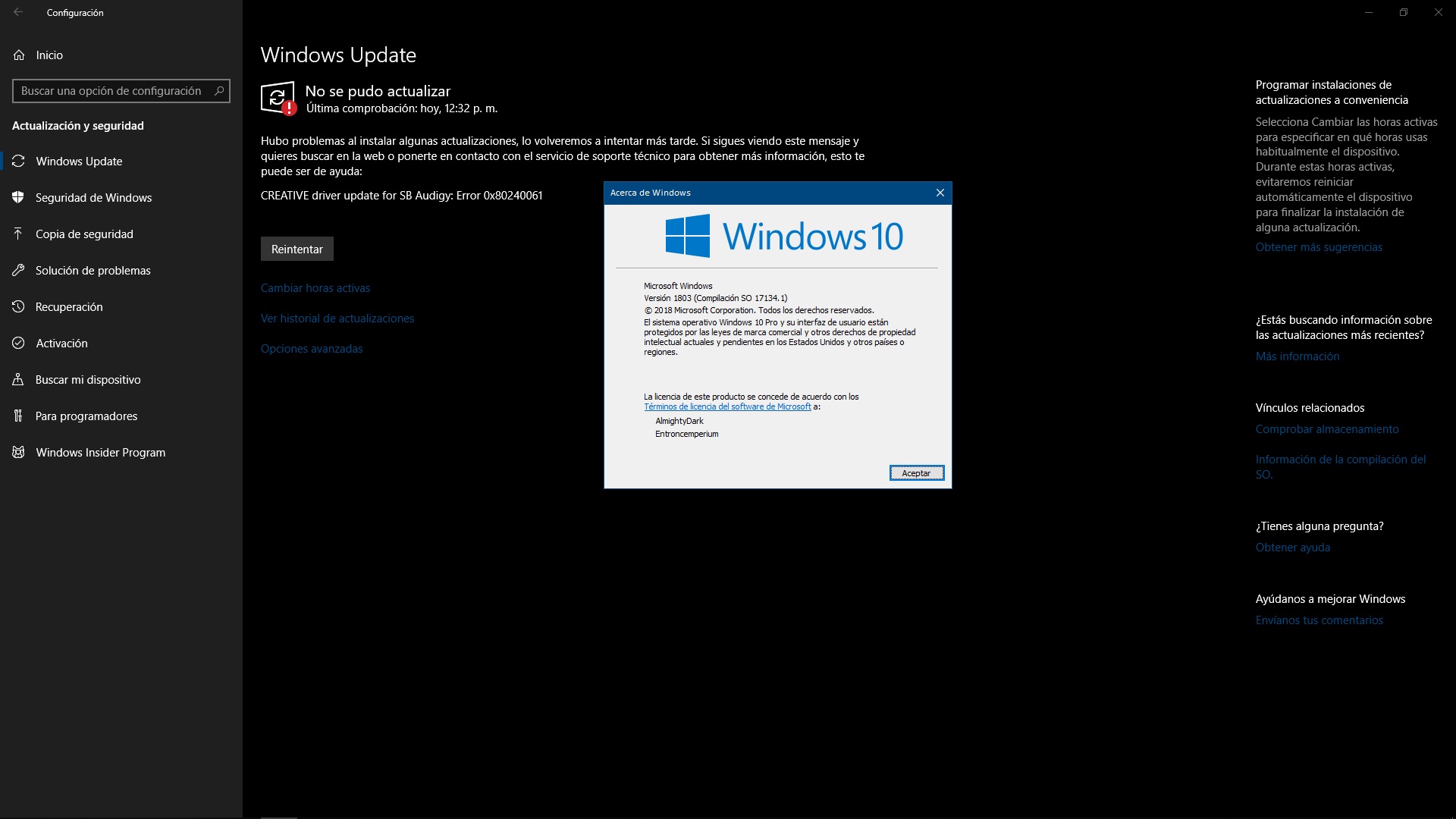

  3. CREATIVE driver update for SB Audigy: Error 0x80240061
    After clean install of Windows 10 - 1803 final version.
    Update try to download driver for my Sound Blaster Audigy 2 and gets the next error.
    Creative SB Audigy 2 ZS driver issue - NO SOUND- after Windows 1903 update 34648ff7-ec57-4a19-9b29-48c8b16a8bbe?upload=true.jpg
    AlmightyDark, Apr 30, 2019
