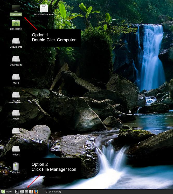

    Step 1
    Once the Desktop appears do one of these:
    1. Double click on the Computer icon
    2. Click the File Manager icon

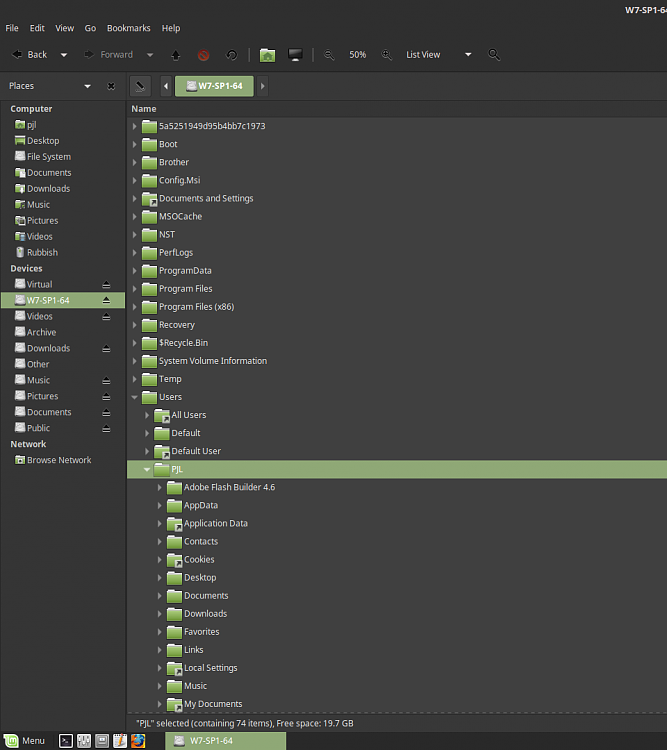

    Step 2
    Browse to the folder that has your files
    Even though it looks different to Windows it works basically the same
    The left pane lists the drives/partitions on your machine
    The right pane shows a directory/folder tree
    You can double click on a folder to view its contents (the tree structure will start at the folder you clicked)

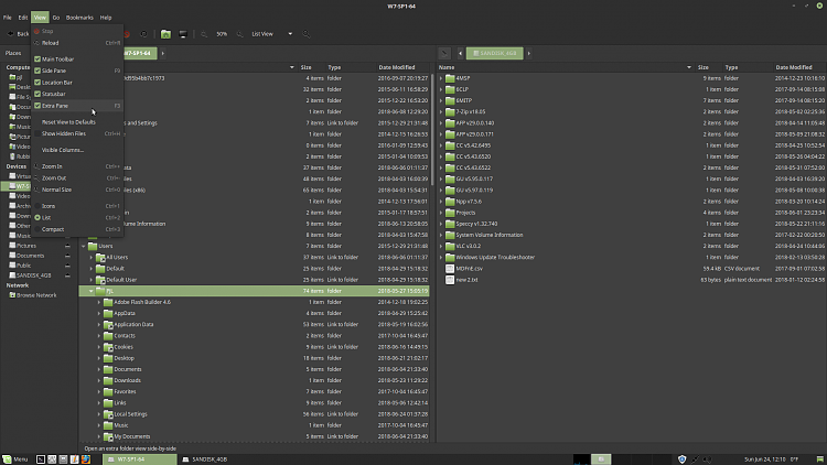

    Step 4
    You can open a twin pane view to make transferring the files easier.
    1. Go to the View menu and choose "Extra Pane"
    2. Click in the new pane (right pane) and then click on your USB drive (in the left pane which is showing the drives/partitions on your machine)
    3. Click in the pane (middle) that is showing the files/folders you want to save and select them
