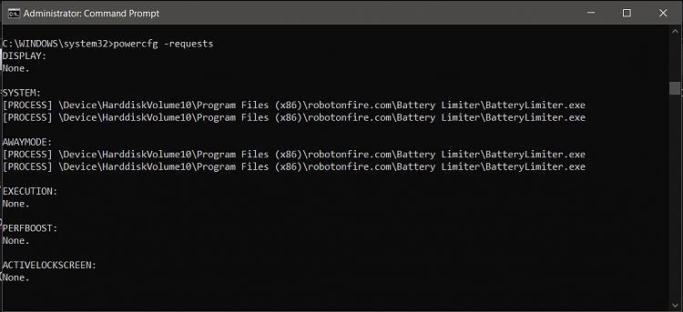

    FYI, In early December, while I had my Windows update over-ride disabled, MS blessed my PC with a new 2004 OS. The sleep function has been completely intermittent and unreliable ever since except for one short period. The previous OS, 1809 worked wonderfully for sleep and auto-brightness adjustments between DC & AC power. All gone now. :-\
    After running powercfg -requests just now, I noted 2 instances of a battery limiter App I use that may have been preventing sleep, fixed now. I'll shorten the delay time for sleep and see if sleep works again.
    DCOMLaunch Service Group prevents my computer going to sleep mode 321812d1615229878t-update-preventing-windows-going-into-sleep-mode-0308-powercfg-requests.jpg

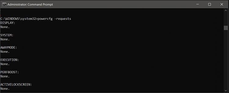

    Update;
    It appears that sleep is working on my PC with 2004, it must have been fixed by MS. *Rolleyes
    I'm glad I didn't clean install 1909 as a fix. *Smile
    DCOMLaunch Service Group prevents my computer going to sleep mode 321821d1615231435t-update-preventing-windows-going-into-sleep-mode-0308b-powercfg-requests.jpg
