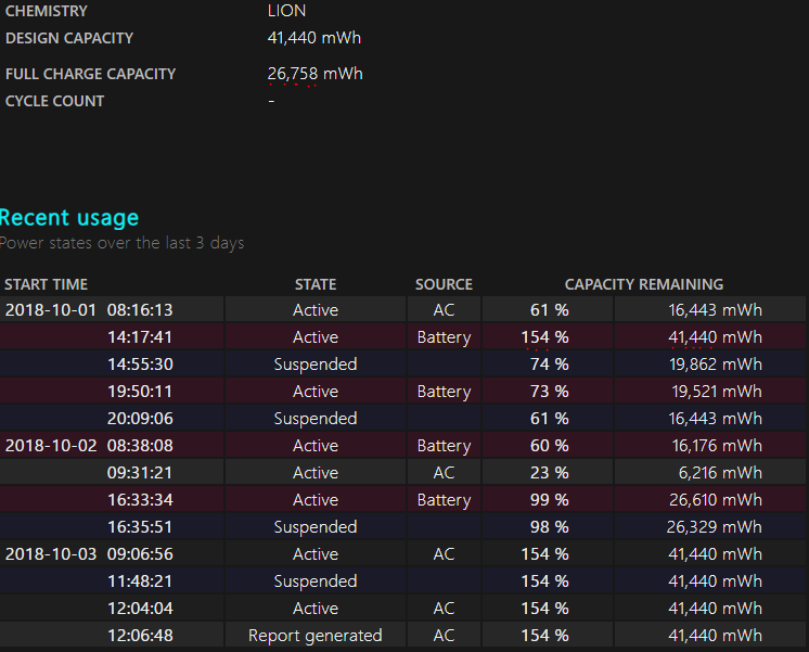

    I have a laptop (Dell Inspiron 3541) with Windows 10. After running powercfg /batteryreport in PowerShell, I got a battery report (at %userprofile%\battery-report.html). However, the results didn't seem right. Here's a screenshot.
    Design capacity is equal to full charge capacity in battery report Q4eoO.png
    As shown by the battery report, my design capacity is 41,440 mWh, but the full charge capacity is 26,758 mWh (about 65% battery health). However, it also shows that it is charging to design capacity (154%), not full charge capacity.
    Some other weird parts of the battery report:
    Design capacity is equal to full charge capacity in battery report zx9LV.png
    My battery has never drained 80% in 40 minutes. 80% in 140 minutes is a much better estimate.
    Design capacity is equal to full charge capacity in battery report 0bsnZ.png
    Over 60 years turned on and on AC in a week? I was running Linux a lot that week, but 60+ years is impossible.
    Is this normal (for a Windows battery report)?
    Zackary, Feb 9, 2024
