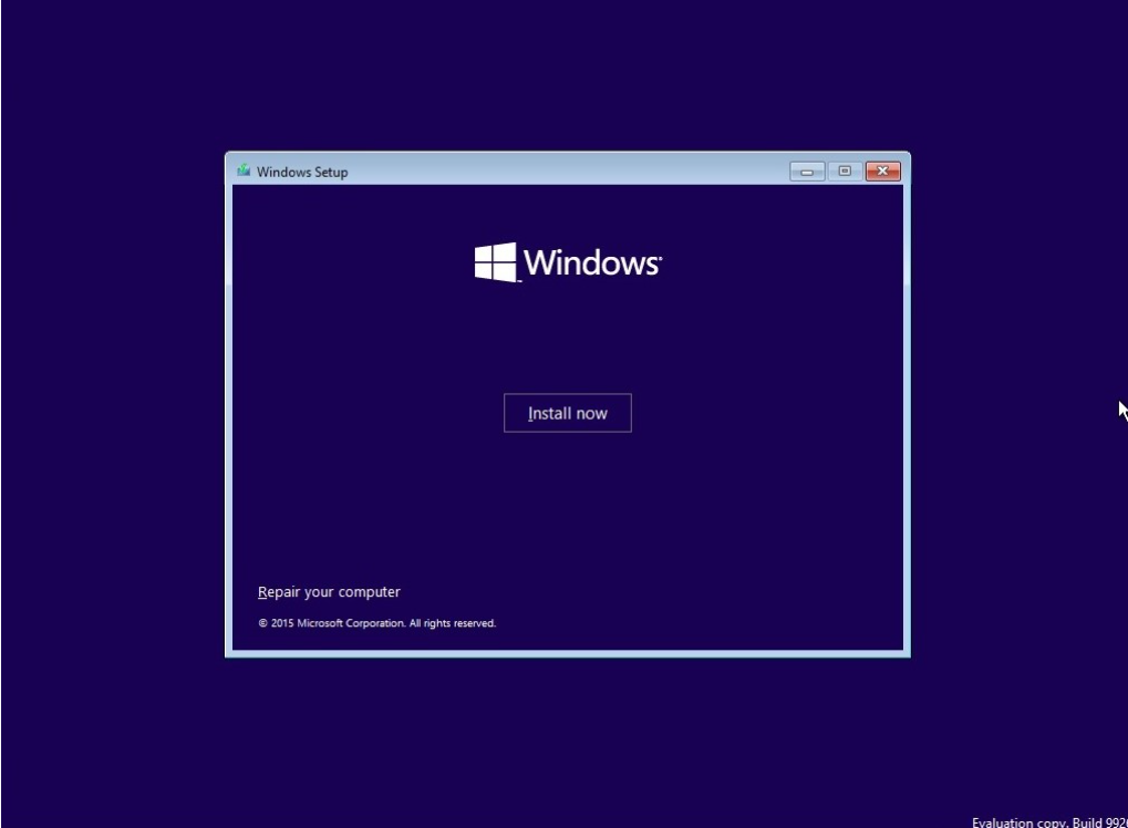

    In my first post to you, I suggested booting from USB installation media and in the second screen that comes up, choosing
    Repair your computer. This is what I wrote back then and
    I still advise doing the same because everything else has failed for you so far. I said then,
    "I would further explore the Advanced Startup Options menu (ASO)..... but this time with one big difference.
    Boot from the USB installation media that you said you made. You are not going to lose anything by booting from this media if you choose "Repair your computer" in the second
    screen bottom left that opens.
    Many computers have a boot menu key that is tapped continuously during the boot process. This triggers the boot options menu.....you would then choose to boot to the USB installation media.
    Desktop Computer Is only able to boot into windows through startup repair menu. af9fc8f0-ae33-4bdd-9fe9-b903b144e16e.png
    In the second screen that opens, shown above,
    at the bottom left corner is "Repair your computer" option. Select this...it will take you back into the ASO menu......but this time you have booted installation media plugged into a port and this should make a difference
    with choices available there. The options work better when installation media was booted from!
    You have previously worked through these options earlier, but you must do it again because you booted from the installation media, and
    that makes a difference in functionality of the options. Try options in this order.
    1. Reset....keep files but lose apps
    2. System Restore Points
    3. Startup Repair
    Advanced Startup Options menu can work better with installation media connected and booted from.
