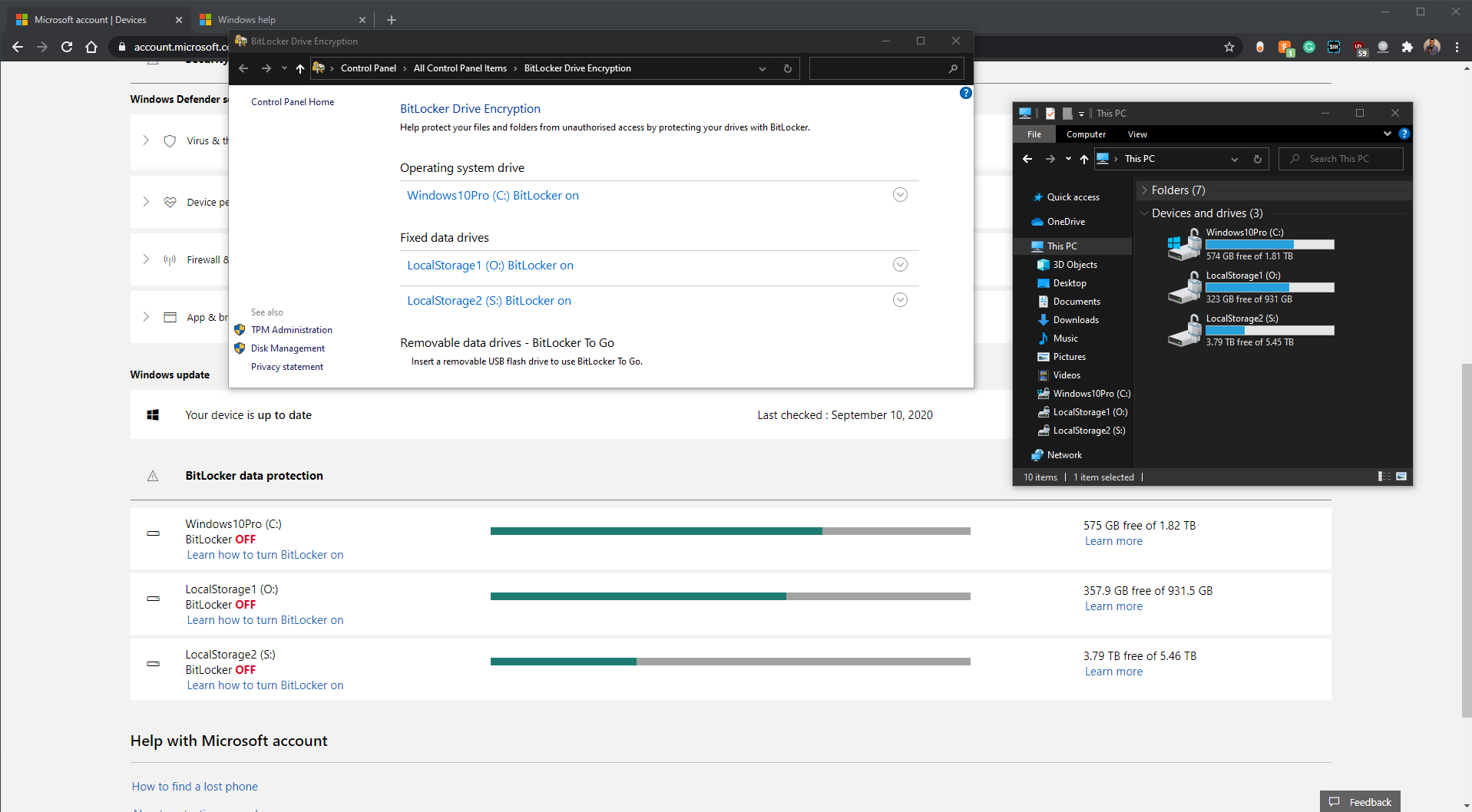

  4. Determine Bitlocker status / enable in Windows 11 Home without Microsoft Account
    BitLocker status "ON" but Account Shows Status "OFF"
    Hi All,
    I am making a set of small assumptions around BitLocker here. So feel free to point and laugh if I have got it all wrong.
    I recently turned BitLocker on for all my drives and selected my Microsoft account as my recovery key location.
    My BitLocker manager within Windows indicated that Encryption is done and all drives have BitLocker turned "ON".
    However, I noticed that within my Microsoft Account Manager on the browser, all three drives have my BitLocker status as "OFF".
    Assuming the "OFF" is an indicator as to if BitLocker is enabled or disabled, why do I have an "ON" status within Windows and "OFF" on my Microsoft account?
    Determine Bitlocker status / enable in Windows 11 Home without Microsoft Account 0064cc35-69f1-476f-a88c-520681054290?upload=true.png
    JOTA_Satellite, Jul 18, 2022
