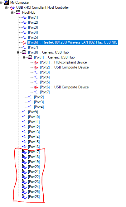

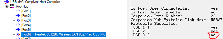

    One interesting thing comes from the usbview program. Notice that "Supported Protocols" is NO for 3.0:
    "Device can perform faster when connected to USB 3.0 port" - it already is. a951408e-880a-483b-9011-b2e4193f40d9?upload=true.png
    Also, all the USB 3.0 ports (circled in red) don't appear to be connected:
    "Device can perform faster when connected to USB 3.0 port" - it already is. 3afff004-3ee3-4e44-8d18-84319f9ccdee?upload=true.png
    J. Randall, Sep 6, 2020
