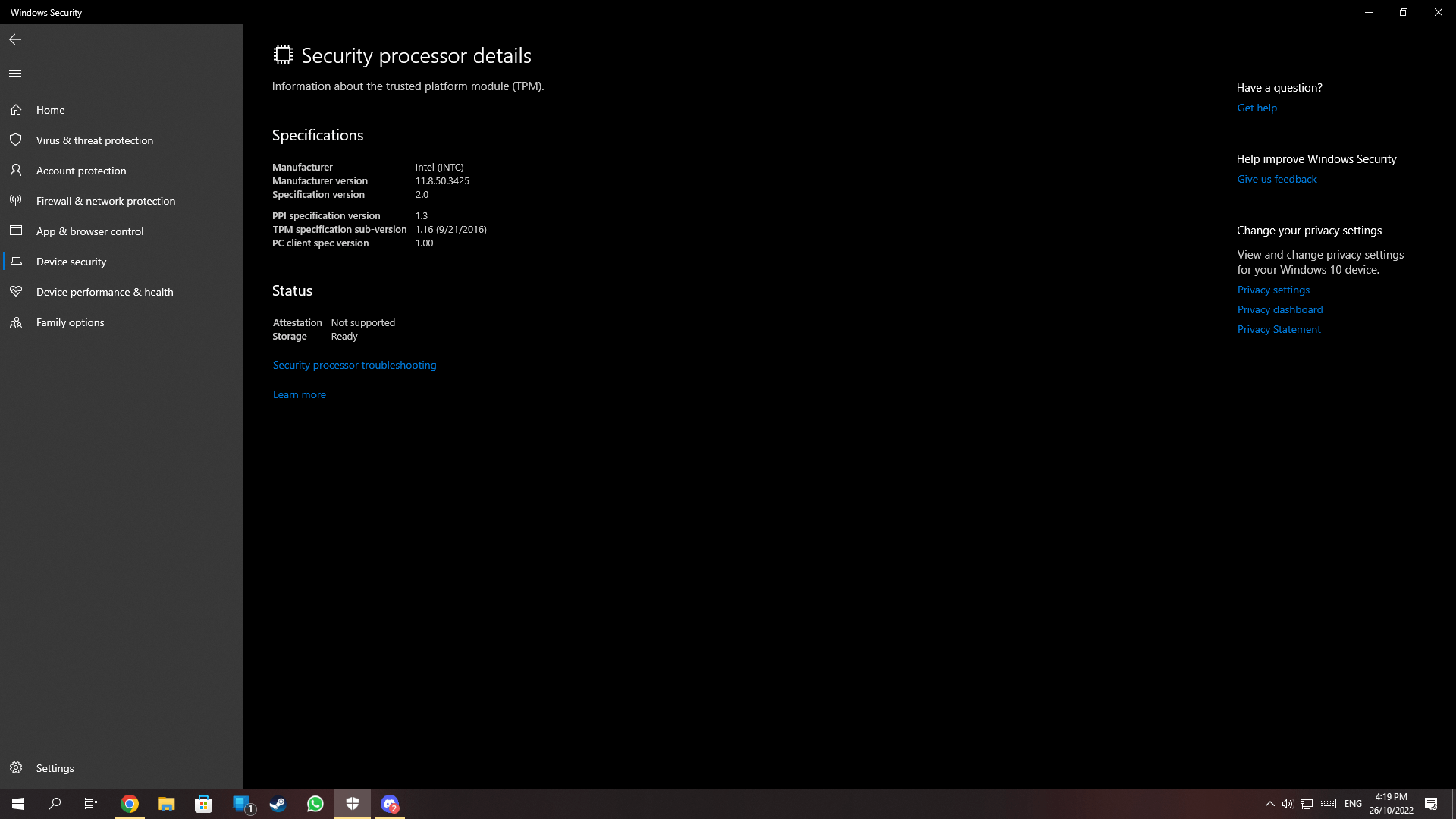

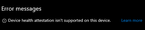

  4. Device health attestation not supported error.
    "Device health attestation isn't supported on this device"
    Hi there.
    When going to windows security, device security and then security processor details, Attestation shows "Not supported" under status.
    Device health attestation not supported error. 6bd6a636-9fc4-4c7d-9077-14344f64ccef?upload=true.png
    And when I click on Security processor troubleshooting, it tells me "Device health attestation isn't supported on this device.".
    Device health attestation not supported error. cbe02e7d-50f4-480e-beab-bea7d1c4aa51?upload=true.png
    What could be the cause of this? Is it possible to fix it and get attestation to work?
    My device specs are as follows:
    Intel core i5-7500 processor
    16 GB RAM
    GTX 1060 3 GB graphics card
    B250-HD3P-CF motherboard.
    عمير سلمان, Jun 18, 2023
