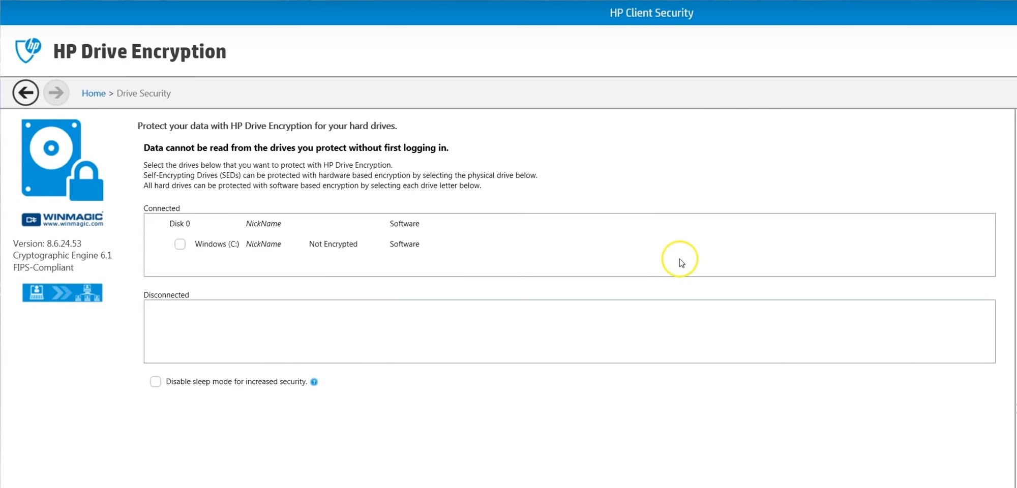

  4. Device manager access denied. Can’t find my camera too. Does that mean i got hacked?
    "Device Access Manager has denied access to CD/DVDs"
    Hello Donald,
    This error seems to be caused by HP Client Security/Device Access Manager blocking access to USB/external devices.
    Upon further researching, "HP Device Access Manager allows an administrator to restrict and manage access to hardware. Device Access Manager can be used to block unauthorized access to USB flash drives where data could be copied. It can also restrict
    access to CD/DVD drives, control of USB devices, network connections, and so on."

    Meanwhile, I'd recommend performing the steps below to enable access to your external flash drive:
    1. Click or tap on Start, search for HP Client Security.
    2. Under Device, click or tap Device Permissions.
    3. In the Device Class, make sure to set the access to
    Allow-Full Access.
    You may also try checking the Drive Security and see if your external drives are restricted:
    Device manager access denied. Can’t find my camera too. Does that mean i got hacked? 456beceb-7cfc-4c64-8756-9d4e28dc9c32?upload=true.jpg
    Device manager access denied. Can’t find my camera too. Does that mean i got hacked? 1612a583-4b66-406c-ae64-3cb8f3e53e07?upload=true.jpg
    Note: "Standard user can view their current device access. Administrators can view and make changes to the device access that is currently configure for the computer by clicking or tapping Change, and then entering the Administrator
    password."
