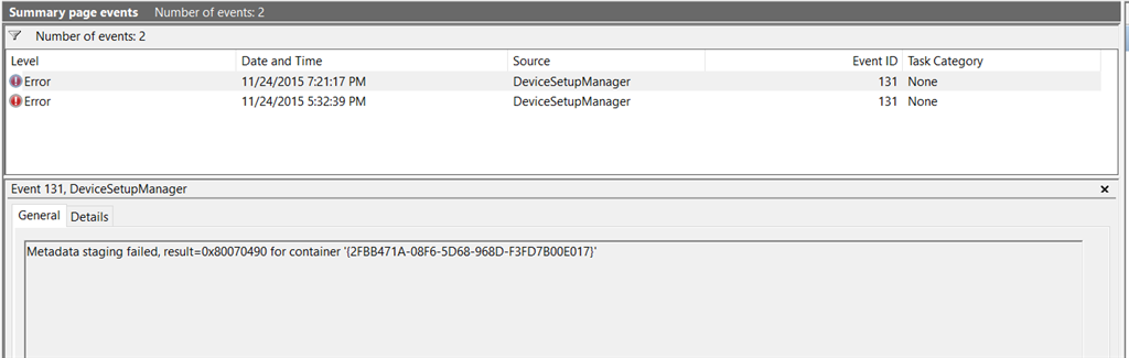

  4. Scott 98 Win User
    Device Setup Manager Metadata staging failed Event ID 131
    Windows 10 error id 131 metadata staging failed after upgrade to Windows 10 from Windows 7
    this error started after upgrade to windows 10 from windows 7 it is id 131 device setup manager metadata staging failed I am attaching a picture of event viewer showing errors these errors happen almost every day.
    Device Setup Manager Metadata staging failed Event ID 131 4725912d-2451-446d-9b25-478310d9a7a4.png
