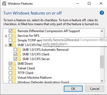

    As you will have found, there are many posts about this issue and unfortunately there are many proposed resolutions. Enabling SMB 1.0 and the Services listed below normally resolves the issue.

    Older and non compatible devices need SMB 1.0 to be visible on the network and this would need to be enabled on all devices as well not just the PC you are describing.

    If you have ensured SMB 1.0 is enabled, SMB Direct, as per the image image below
    Devices / Computers not showing up in Network 222213d1548493567t-2-3-computers-home-network-only-show-multimedia-devices-smb.jpg

    then try and force the settings again, try clearing the the SMB 1.0 and SMB Direct settings completely and restarting, then select them as per the image above followed by a restart.
