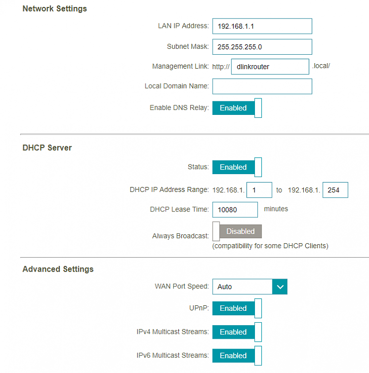

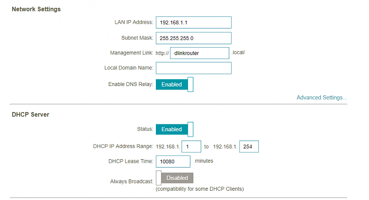

    I just installed a Dlink DIR-890L and it is setup to assign devices to the range 192.168.1.1 to .254
    Devices looking for connection in the wrong subnet 146536d1501546994t-wifi-devices-connecting-wrong-subnet-image.png
    However, it seems that when most of my devices connect they are ending up with an IP address that is 192.168.0.something.
    This is causing the device to be able to connect to the router but not to the Internet. It has happened with my laptop, 2 cell phones and wireless thermostat. I have no idea why. Right now I am going into each device and changing the default IP and then manually changing its gateway to 192.168.1.1 (it's also coming up wrong)
    I have no idea why this is happening.
    I see this in the router settings but there is no where to change the default gateway but I'm not sure if I need to and so far I have been changing it to 192.168.1.1 on all the devices that I have to manually configure/

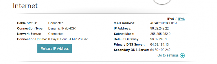

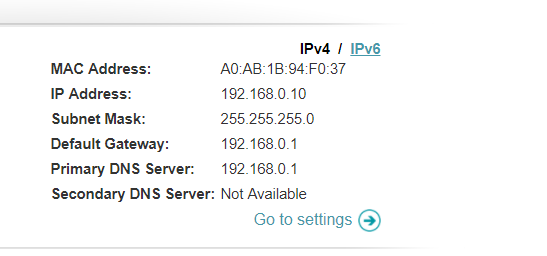

    OK thought I had it figured out, but I reset TWO computers that are hard wired to the router and both got assigned an IP address that is 192.168.0.XXX
    I have no idea how this can be happening. Only think I can think of is that I changed dlink from being in the 192.168.0.XXX range to the 192.168.1.XXX range and maybe there is a glitch in their firmware.
    The router isn't actually in bridge mode, but IP PASSTHROUGH mode, and it is passed to the MAC Address of my dlink router, not sure what else I can do??
    Devices looking for connection in the wrong subnet 146733d1501653776t-wifi-devices-connecting-wrong-subnet-image.png
    The IP Address of router is now showing as my external IP address so the passthrough is working correctly.
    Devices looking for connection in the wrong subnet 146734d1501653838t-wifi-devices-connecting-wrong-subnet-image.png

    Looks like you had two devices running DHCP. First come first serve is how it works. So your "modem" was still acting as a router and DHCP server. Bridge mode stops that.
    Regarding the scope. You have it set from 1.1 to 1.254, you can change it but honestly it makes no difference. The protocol has mechanisms to avoid duplicate addressing and not worth the hassle tweaking.
