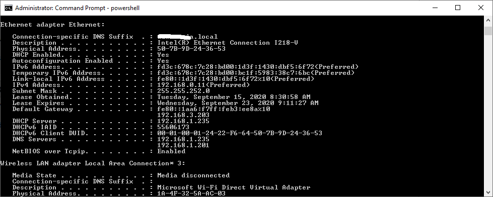

    Hello Everyone ,
    have a problem since 2 days some pcs getting ipv6 and for your info i deploy DHCPv4 only on windows server 2016 .
    can i know who DHCPv6 server or Device .
    WalidFawzy1, Sep 15, 2020
