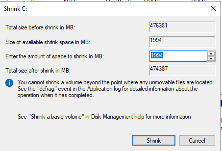

Discus and support disk shrinking problems? in Windows 10 Network and Sharing to solve the problem; im trying to shrink my disk volume and it says this I cant change it to 10000 just 1994? [ATTACH]... Discussion in 'Windows 10 Network and Sharing' started by myles bock, Mar 16, 2021.
  1. disk shrinking problems?
    im trying to shrink my disk volume and it says this I cant change it to 10000 just 1994?​
    disk shrinking problems? b21a2f19-a345-4059-9f0e-e50b1ecd8361?upload=true.png

  2. Martmcd Win User
    Can't shrink system disk
    it normally works fine without the need to recover from backup - but,
    it only needs to go wrong once - you are making major changes the the partition - the choice and risk is yours.
    the chances of it going wrong are slim but if it does, the consequences are major.
    there are some files windows, can not move.
    disk management will only shrink the disk to the position of an "unmovable file".
    it MIGHT be the virtual memory file that is preventing disk management from shrinking the partition.
    you could try setting virtual memory to be only on the second HDD and turning it off on C: (will require a restart and carries its own risks)
    then try shrinking the disk with disk management
    then put the virtual memory back.
    My original suggestion is easier, safer and will work.
    Martmcd, Mar 16, 2021

  4. disk shrinking problems?
    undo partition shrink
    If you accidentally shrink the volume of your SSD partition, there is an option to extend the volume as well. To extend the volume of your SSD partition, follow the steps below:
    • Press Windows key + X on your keyboard and select Disk Management.
    • Right-click the partition that you want to expand and click Extend Volume.
    • Select the amount of space that you want to extend.
    Keep us in the loop with the result.
    Gerard Qui, Mar 16, 2021
