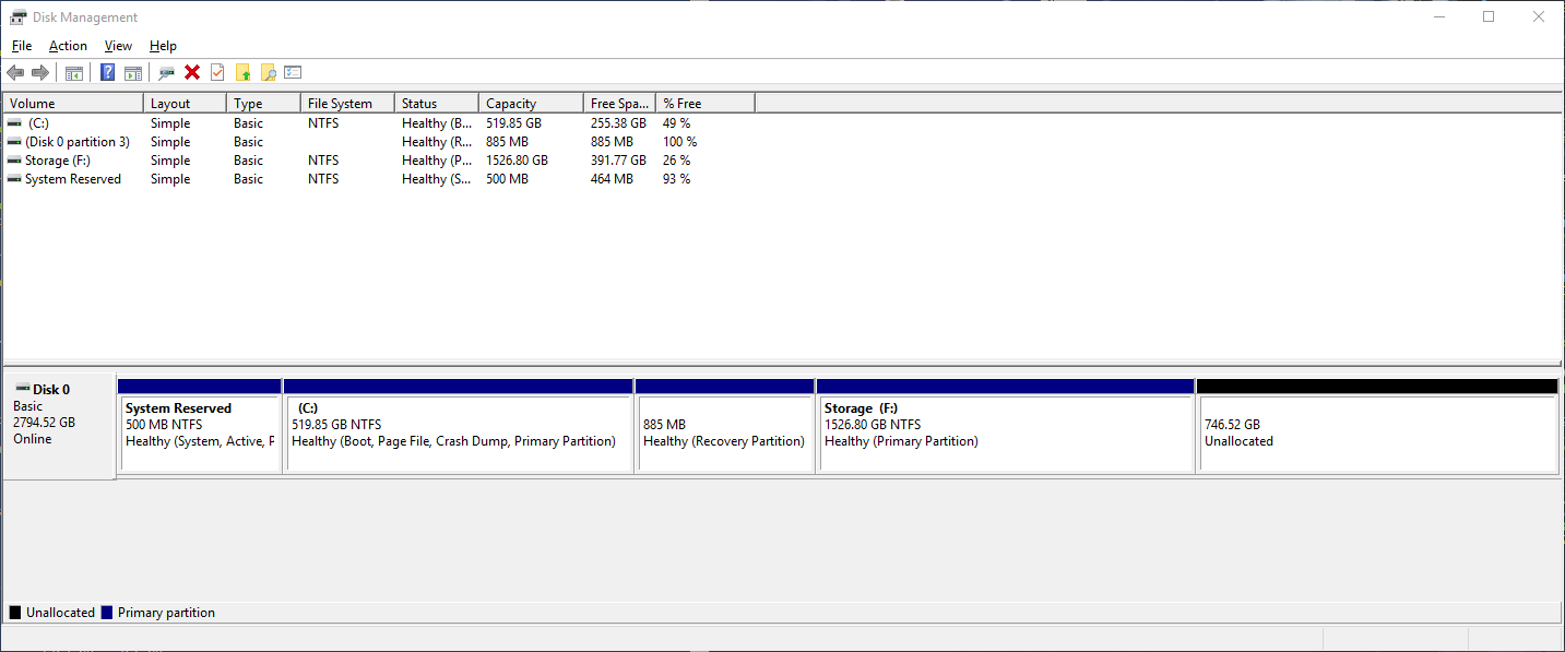

    When trying to convert to GPT, I get this error:
    Here's diskpart info:
    And here's a picture of disk management:
    I've tried shrinking the storage by a few GB in case it was the issue, but no luck. I'm kinda out of ideas. Maybe the recovery partition counts as a primary partition and thus I go over the 3 primary maximum? It shouldn't, but that's the only idea I have left.
    Niko Matikainen, Jun 25, 2021
