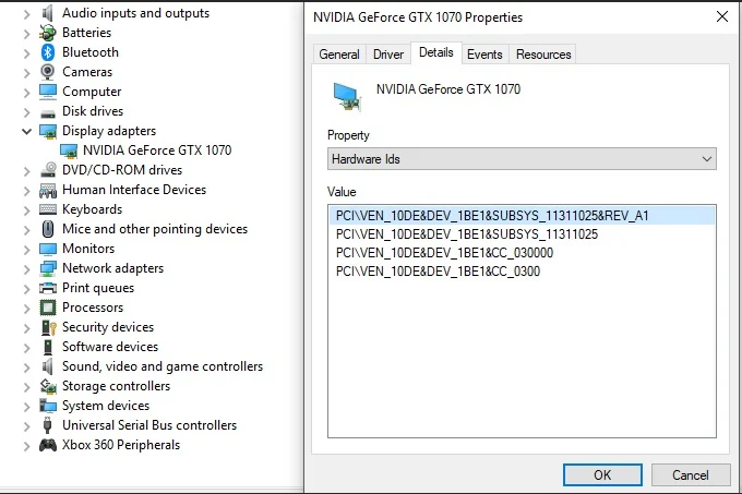

    I had this issue about 2 months
    Where I had a windows update then my display driver freezes
    all programs are running since I can hear my video playing,
    only the screen hangs, no BSOD, or blackscreen.
    When I reboot, the screen hangs on windows log-in screen
    SPECS: GTX 1070 i7 16gram
    Predator 15 g9-593 laptop
    Ive tried:
    • clean installation of windows 1709, 1903, 2004,
    • cleaned drivers DDU & also tried installing in safe mode
    • Set things to maximum performance, PCI Express off, fast start-up off
    • Cleaned my fans/ repasted thermal paste
    • Disk install via device manager
    • hardware troubleshooter
    • Disabled TdrDelay
    • Updated all drivers except for display adapter, since i will get an error if i update it
    The stock driver from Acer VGA 384 works at any given time.
    Nvidia drivers 384 - 388.92 works. beyond that nvidia 390+ i got driver error
    My only solution was to use older version of windows 1709, installed in legacy mode because i noticed screen freezing only occurs in windows OS 1903 & 2004.
    I can update the driver to new versions like 451.67 but the computer wont recognize it upon initial install error 43, where i need to uninstall it via device manager then reboot..
    upon then the VGA would reset and function, but my brightness control will be broken.
    weird because I was running lastest drivers since last year, until i got my display freezing now
    Ive attached my hardware ID just in case
    Any solution would be gladly appreciated.
    Thank you very much
    Display Driver Freezing Upon Windows Update ca910592-4e2d-422b-94df-b6b4dea3699b?upload=true.png
