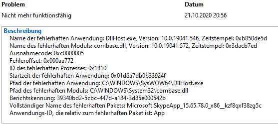

    since a few version of Skype can't say since when, when always I start Skype and check the Reliability Monitor, I get a critical alert about DllHost.exe.
    So when I check for Details, as I said, this happens when Skype start:
    DllHost.exe combase.dll crash when start Skype f4a65ef6-7361-48fe-bbef-bbcf14dcaab1?upload=true.png
    Skype itself is running fine. So if I wouldn't check the Reliability Monitor, I wouldn't notice.
    Troublshooting steps I have done:
    • Un-/installed the App -> same issue
    • sfc /scannow -> no issue
    • Today I did an In-Place Upgrade to 20H2 with the official MVS ISO file -> same issue
    Did anyone else notice it? What could be the reason?
