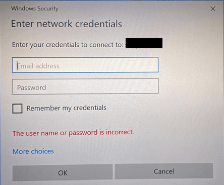

  3. Jan_EW Win User
    Cloud Trust with Azure ADJoinedDevices
    Hello
    I'm trying to setup cloud trust for WHFB. The login with face or finger works fine, the only thing not working is the authentication to on prem-resources.
    When i login with Whfb and try to start an application really any (Exporer, Browser, Windows Settings) following Pop-Up appears.
    Do I need Azure premium for cloud hybrid trust / key hybrid trust or not? 6be4180f-6320-495c-acfa-3ae9c747bfb4?upload=true.png
    When using Username and password I'm able to view the resources, fingerprint and face are not accepted.

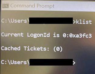

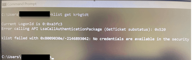

    When trying to view or get my krbgt ticket I get following error:
    Do I need Azure premium for cloud hybrid trust / key hybrid trust or not? 56645ac7-18e7-4c98-8e1d-a02ec5be51d2?upload=true.png
    So from my understanding cloud trust doesn't send the credentials to verify to on prem AD am i correct?

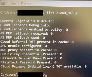

    Here is some Additional Info that might help:
    Do I need Azure premium for cloud hybrid trust / key hybrid trust or not? b58dec41-046c-47f4-a530-fc12199c2619?upload=true.png
    Do I need Azure premium for cloud hybrid trust / key hybrid trust or not? 0c5b0853-b65c-4c15-91f2-d209e9ca3cbb?upload=true.png
    I Cant find any useful articles, so I'm hoping to get some help here.
    I followed MS instruction from here: Windows Hello for Business cloud Kerberos trust deployment
    Server and Clients fulfill the Requirements
    Oma-Uri is correct
    Thanks in Advance
