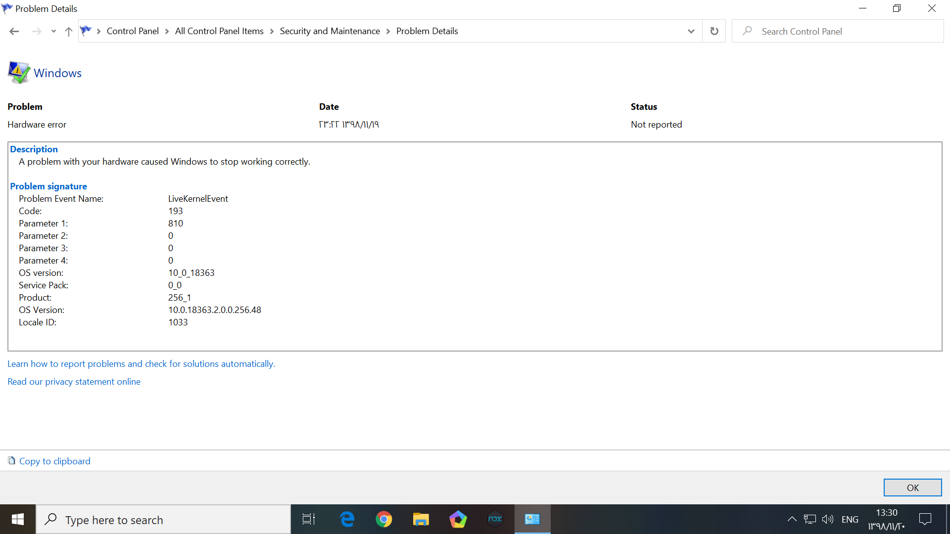

    hi.
    When the system is turned off from sleep mode Sometimes the monitor does not display.
    And the monitor screen stays black. But the graphics card is on and the fans are spinning. The keyboard freezes and nothing can be done. I can only restart from the case. This error is written after the system comes up.
    Do not display the monitor after sleep mode b932e6e7-d92d-469d-938a-0ab6a862bd57?upload=true.png

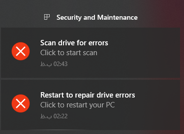

    I scan the Windows drive. An error is found. When I turn off the system and then turn it on, the error is fixed. But sometimes when I do the repair and the system restarts, Windows does not boot. And I have to reinstall Windows.
    This error is also usually given in these cases.
    Do not display the monitor after sleep mode 1d4f0c01-95ad-49be-9d7b-d861cfad0911?upload=true.png
    I updated the BIOS and disabled the fast boot and … But it was not resolved.

    I changed the graphics card and used the gtx650, and this error no longer occurred. So most likely the problem is the graphics. But I don't know what's wrong. The following are the errors shown in the system.
    The motherboard also shows the graphics error with a beep. This happens even during the Windows installation process
