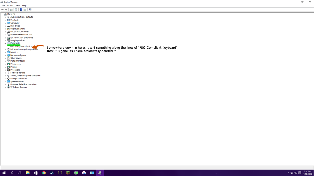

  3. dave_- Win User
    PS/2 keyboard and mouse troubles
    My PS/2 keyboard was acting up, every time I pressed the left 'ctrl' key, it had opened up the file explorer. That is no longer my problem.
    I, thinking I was the smart one, decided to go to the Device Manager and try to sort this out myself. Well, I made a huge mistake. Under where it says "Keyboards" I had 'accidentally' told it to delete my PS/2 keyboard from the devices list! Now, no PS/2
    device will work, no mouse or keyboard or anything! I'm forced to use a USB keyboard, which I don't like, as that PS/2 keyboard was my favorite. It was the best keyboard I had ever used.
    No PS/2 keyboard or mouse will work on my system at all now, not even in BIOS. I've tried everything I could think of, and I still haven't managed to fix it.
    Does Windows 10 support PS/2 type keyboards mouse? bebd4b67-3f4f-452a-a743-64be2eef878a.png
    Thank you all for help!
    dave_-, Jan 5, 2023
