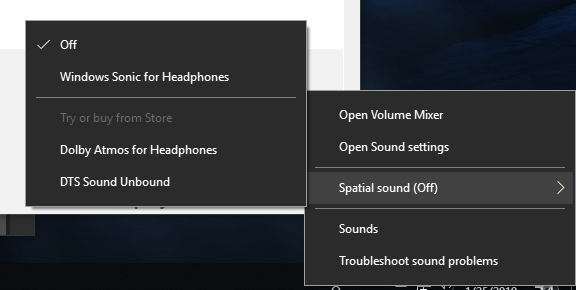

  4. Dolby Atmos Only Works on Other Devices When Headphones Is Set to Default. HELP
    No option to enable Dolby Atmos for Headphones?
    I had Dolby Atmos for Headphones working on an old PC. I decided to upgrade and when I did I realized I was no longer able to select Dolby Atmos for Headphones in my spacial sound settings. I installed the app and when I did, the Spacial Sound setting changed
    from "Dolby Access" to "Dolby Atmos for Headphones"

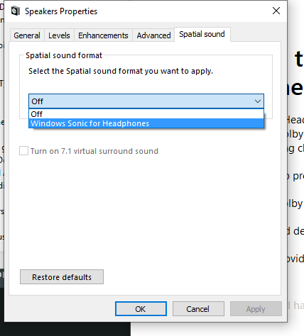

    However, when I go into preferences for my device and look at the spacial sound settings, I am greeted with this...
    Dolby Atmos Only Works on Other Devices When Headphones Is Set to Default. HELP 5559fd0f-6944-40e8-a285-ad341f02ba03?upload=true.png
    No option to enable Dolby Atmos for Headphones.

    FallxnShadow, Dec 16, 2022
