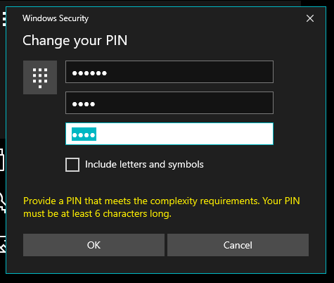

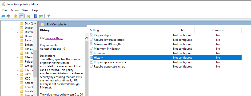

    I had an issue where I added a new Microsoft account that has corporate/domain policies to my personal computer. When setting up Teams I mistakenly agreed to let the domain policies apply to my computer. Immediately settings changed and one of the things
    that happened was I had to change my pin due to the policy change. I have since removed my device from the domain and confirmed with the domain admin that my device is not registered but I cannot change my PIN settings. When I go to look at the policies I
    see this:
    Domain policies resets my PIN 56a1cce2-f79c-4e2c-bbc2-1465c2ebf014?upload=true.png
    But when I go to change to my PIN back to what it was originally I get this:
    Domain policies resets my PIN 4ee79238-1371-4752-beed-a583f64fae1a?upload=true.png
    I don't understand why this would be and can only assume that there are still some domain policies applying. Any suggestions on how to fix this would be appreciated.
