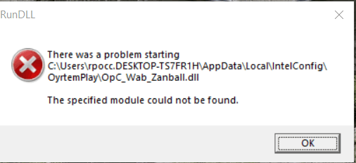

    Thank you very much for this response. I did as you suggested and since you pointed to the Portuguese language pack specifically, I removed that language first. I ran the MalwareBytes scan and it found a file called OpC_Wab_Zanball.dll which was quarantined (and I've since deleted). After a reboot, I reinstalled the Portuguese language pack and now all accents--both French and Portuguese work as expected. This was really great advice.
    When I reboot, I now consistently receive this error message, but I just click OK and it goes away. I can't find anything about this Zanball or OyrtemPlay online so this was clearly the culprit. This pop-up DLL error will hopefully resolve itself with time and future updates.
