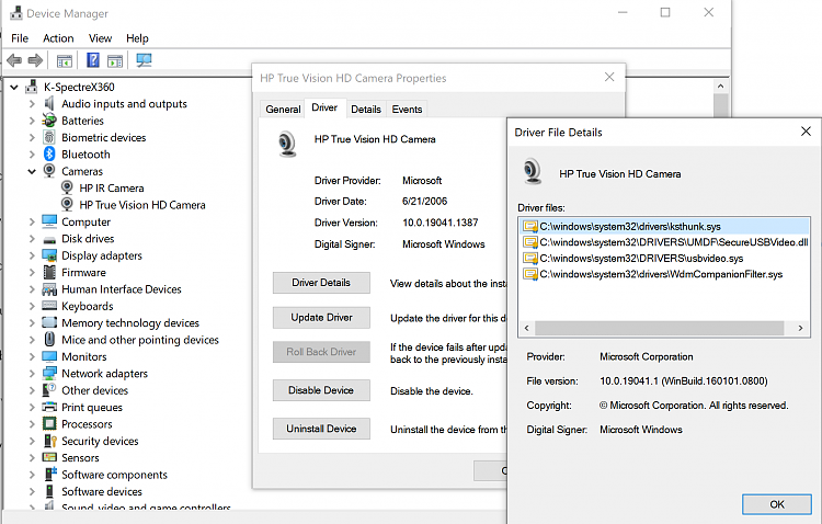

  4. rklug1521 Win User
    download camera driver for HP Spectre 360
    HP Spectre 360 15" UHD: NO camera after Windows 11 upgrade
    I have the same laptop as you (15-eb1043dx) and found your thread while trying to figure out why my laptop fails during the Windows 11 upgrade process. The picture below are the camera drivers shown in my device manager after my computer reverted back to Windows 10. When you flip your camera switch, do you see the little flap cover and uncover the camera? When the camera switch is off, the hardware actually puts a little cover over the camera (you'll see little black and white diagonal stripes in the rectangular camera window when the camera is covered and off) and actually disconnects the camera's internal USB connection from the system. When I turn my camera switch off, the camera disappears from Windows 10 device manager. Maybe something isn't working right with your camera switch or it's stuck off? Not to hijack your thread, but did you have any other issues upgrading to Windows 11? I seem to have some driver issue causing it to bluescreen during the install.
    download camera driver for HP Spectre 360 40d1645979416t-hp-spectre-360-15-uhd-no-camera-after-windows-11-upgrade-hp-camera-device-manager.png

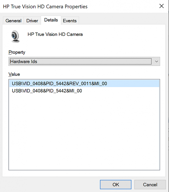

    - - - Updated - - - I just realized you probably wanted this picture as well.
    download camera driver for HP Spectre 360 360941d1645980409t-hp-spectre-360-15-uhd-no-camera-after-windows-11-upgrade-hp-camera-device-id.png
