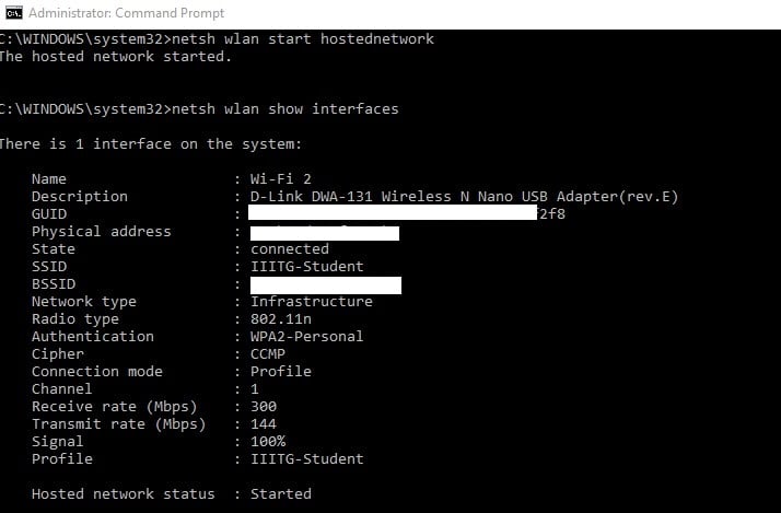

    netsh interface set interface name="Wi-Fi" admin=disabled
    netsh wlan set hostednetwork mode=allow ssid=Your_SSID key=Your_Passphrase
    netsh wlan start hostednetwork
    netsh interface set interface name="Wi-Fi" admin=enabled

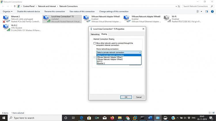

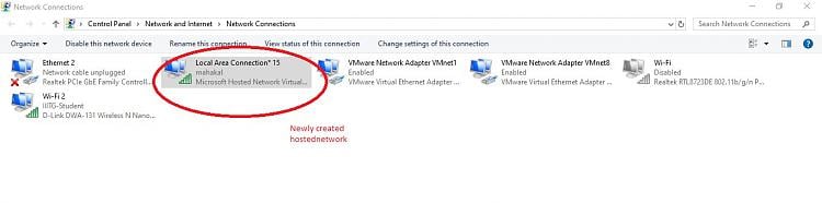

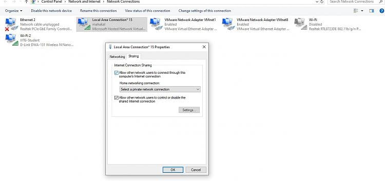

    so I was able to start a hosted network wifi hotspot on USB wifi. Which can be seen as Wi-Fi2 as connection name on all outputs on command prompt and in gui as well.
    Download Windows 10 from usb and no wifi or internet 253644d1572945334t-share-internet-via-usb-wifi-device-windows-10-a-all-wifi-adapters-normal.jpg
    Download Windows 10 from usb and no wifi or internet 253645d1572945413t-share-internet-via-usb-wifi-device-windows-10-a-netsh-show-interfaces-.jpg
    Download Windows 10 from usb and no wifi or internet net-via-usb-wifi-device-windows-10-a-allowing-internet-connection-sharing-virtual-wifi-adapter-1.jpg
    Download Windows 10 from usb and no wifi or internet 253646d1572945480t-share-internet-via-usb-wifi-device-windows-10-a-select-private-connection.jpg

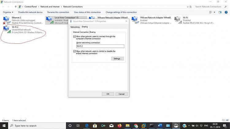

    Now when I tried to share the internet on virtual wifi adapter which is Local Area 15 in above screenshots then the internet connection on usb Wifi2 adapter got disconnected.
    Download Windows 10 from usb and no wifi or internet 649d1572945576t-share-internet-via-usb-wifi-device-windows-10-a-mahakal-shared-wifi2-disconnects.jpg
    so now I go one step back and disable internet connection sharing on virtual wifi adapter I get my internet back on laptop. It is back as normal.
    So I have been able to create a virtual wifi adapter on USB Wifi adapter but I could not share the internet. What is this error and how can I fix this?
