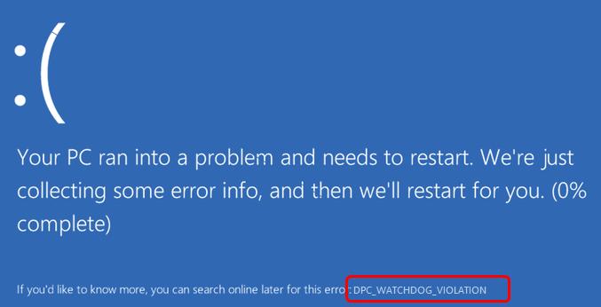

    DPC _Watchdog_Violation error in Windows 10 while playing games on my laptop
    Hi Guys, a Few weeks back I was playing PUBG on my Windows 10 laptop. Suddenly a blue screen popped up with a sad face and some error text i.e. DPC _Watchdog_Violation error.
    If you regularly update your Windows 10 operating system than there is no chance you will get this error. So always update your Windows 10 to the latest so that all Windows enhancements and fixes can be applied to your system.
    DPC _WATCHDOG_VIOLATION 1f195cb9-2e26-44ad-a028-137a4f25da92?upload=true.jpg
    I searched for the error and found that this error occurs due to incompatible SSD drivers that comes with the Windows 10 Operating system.
    So today i thought to write a solution for this error. If you are facing the same issue, then here is how you can fix DPC Watchdog Violation error.

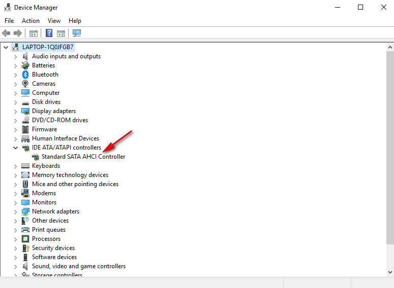

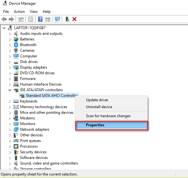

    • The first thing you want to do is open the Device Manager in Windows 10. Just go to Cortana and search for Device Manager.
    • Once you have it on your screen, expand IDE ATA/ATAPI controllers as you can see in the below screenshot.
    DPC _WATCHDOG_VIOLATION 23c2849f-9ea0-48df-9ed0-800a1c618897?upload=true.png

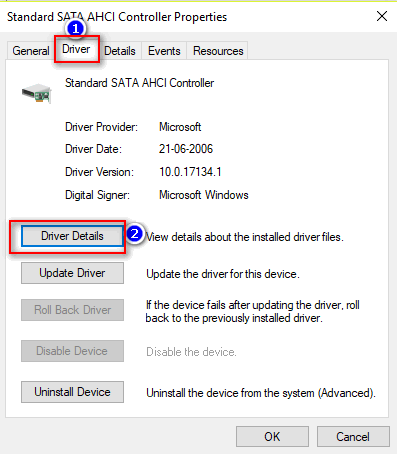

    • Now right click Standard SATA AHCI Controller and click on Properties.
    DPC _WATCHDOG_VIOLATION 572b69b0-352a-4046-b1b4-6d495d94df7e?upload=true.png
    • Now go to Driver tab and click on Driver Details
    DPC _WATCHDOG_VIOLATION 9fa269da-f344-4da0-a4d9-2380c90735a5?upload=true.png

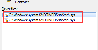

    • Make sure that the driver listed is iaStorA.sys and click
      OK
    DPC _WATCHDOG_VIOLATION 155b6ecf-769e-4379-8318-fc13cb8f5185?upload=true.png

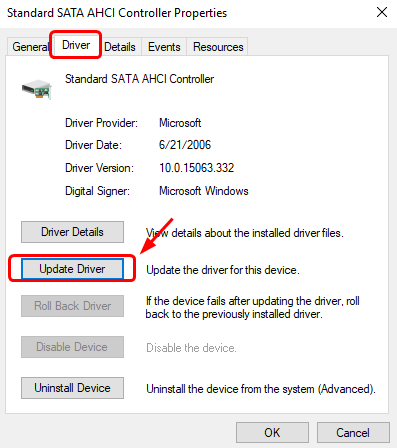

    • Now click on Update Drivers
    DPC _WATCHDOG_VIOLATION a1d394c0-adef-406c-8fb4-ea4f1efa675a?upload=true.png

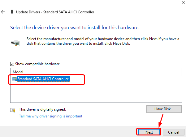

    • Select “Browse my computer for driver software" in the next window.
    • Next, select “Let me pick from a list of device drivers on my computer“.
    • Select Standard SATA AHCI Controller and click Next
    DPC _WATCHDOG_VIOLATION eaba83c0-d4ef-4a82-87cb-dfd79243652f?upload=true.png

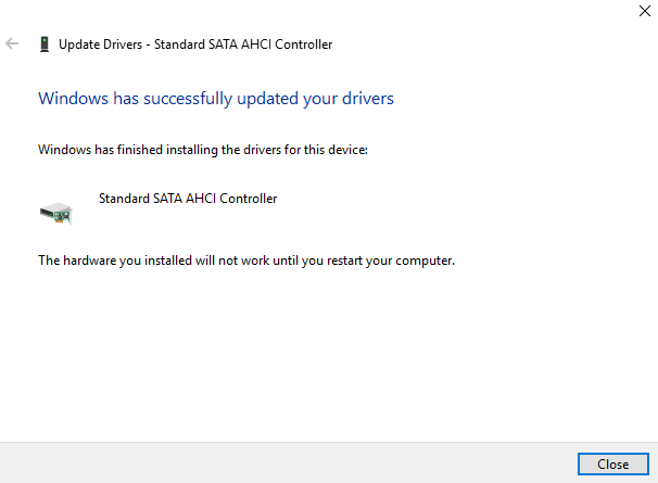

    • In few seconds your SATA AHCI driver will get updated.
    DPC _WATCHDOG_VIOLATION 639e7409-781d-4515-b9d1-da45376cf3c8?upload=true.png
    That's it now RESTART your system once and the DPC_Watchdog_Violation in Windows 10 is fixed.
