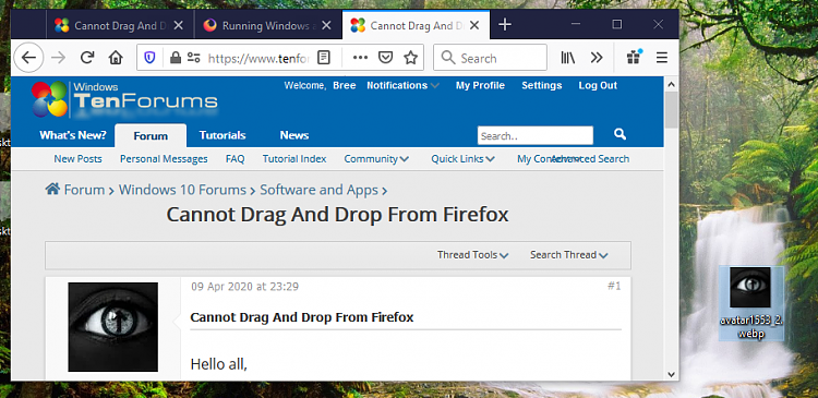

  4. Bree Win User
    drag & dropping image files from firefox creates .url files that cannot be deleted
    Cannot Drag And Drop From Firefox
    Steps to reproduce the problem in Windows 10:
    Enable the built-in Administrator account.
    Sign in as Administrator
    Open Firefox at any page with an image, such as an Avatar image from this page.
    Click and drag the image from Firefox and try to drop it onto the Desktop
    This is not allowed for Administrator, but is allowed for any other user, creating a .webp image on the Desktop that can be opened in Firefox.
    drag & dropping image files from firefox creates .url files that cannot be deleted 273773d1586477169t-cannot-drag-drop-firefox-image.png
    However, I found that when signed in as Administrator in Windows 10 Pro the second suggestion in your link worked for me.
    Running Windows as Administrator with Launcher Process enabled in Firefox causes Drag and Drop errors - How to Fix | Mozilla Support
    I created the following shortcut on the desktop to open Firefox, used it to open Firefox, and could then drop an image onto the desktop.
    "C:\Program Files\Mozilla Firefox\firefox.exe" -no-deelevate
