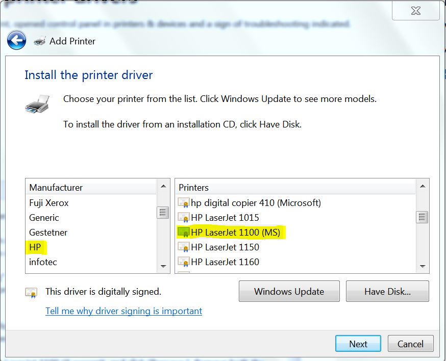

    5. Click "Add a printer" at the top of the Devices and Printers window. Select "Add a local printer."
    6. Select "Use an existing port" and leave the drop-down list set to "LPT1: (Printer Port)" then click Next
    7. On the "Install a printer driver" screen, select "HP" in the left pane.
    8. In the right pane, scroll down. If you find "HP LaserJet 1100 (MS)" select it and click Next and go to step 11.
      drive HP LaserJet 1100 for windows 7 fd9e2ec6-24b7-45e8-be86-888a5a4692cb?upload=true.jpg
    9. If you don't find "HP LaserJet 1100 (MS)," click "Windows Update" and wait. Wait some more; this will take some time.
    10. When the update completes, find and select "HP LaserJet 1100 (MS)" and click Next
    11. Share or don't share the printer as you like (if you do share it, give it an 8 character "Share name" with no spaces and no special characters. Click Next
    12. Set or don't set the printer as the default printer. Don't click "Print a test page" at this point (because you haven't yet connected the printer).
    13. Click Finish
    14. Connect your printer to a USB port and turn it on. It should now install automatically.
