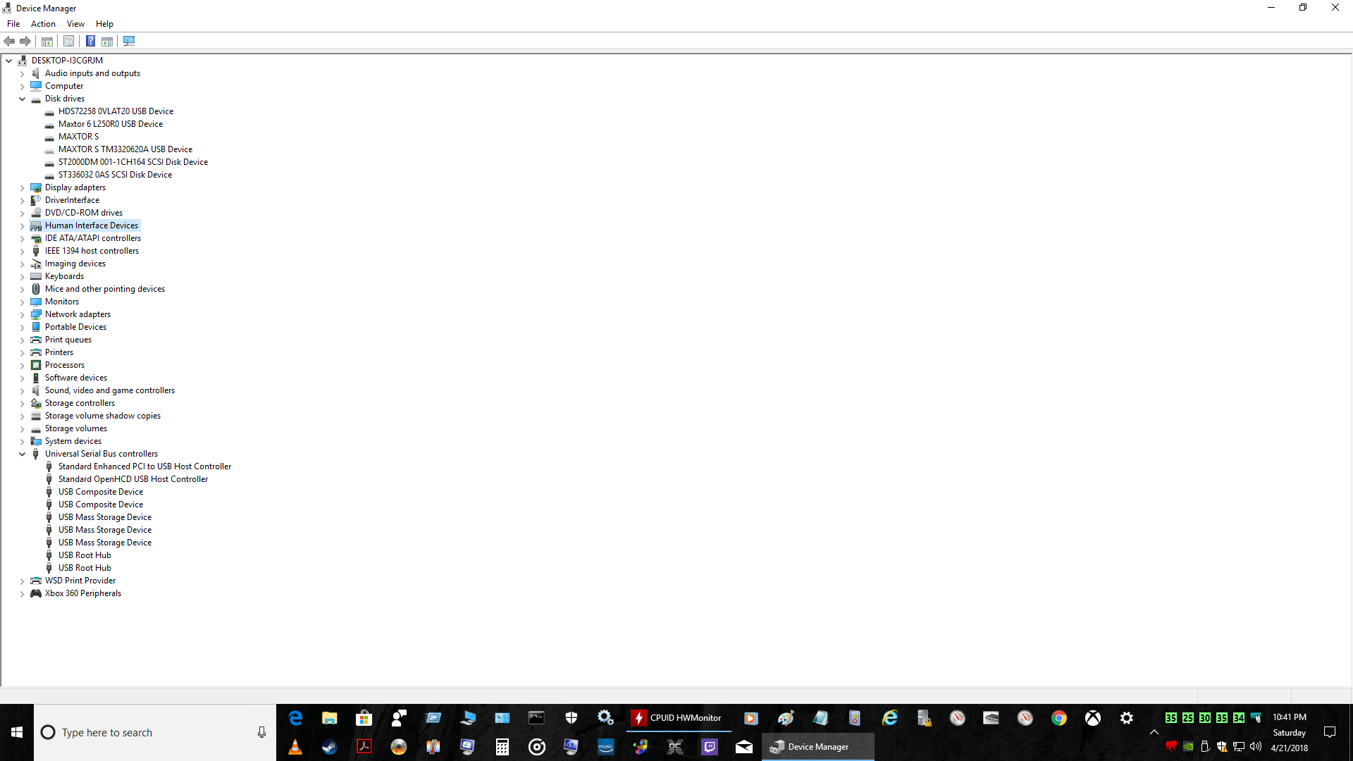

  3. kjl1956 Win User
    Driver Management concluded the process to install driver wpdfs.inf_amd64
    Driver Management concluded the process to install driver wpdfs.inf_amd64_86b72dac27e0ea83\wpdfs.inf for Device Instance ID SWD\WPDBUSENUM\{C3845C8E-45E3-11E8-8060-001E90143FED}#0000000008100000 with the following status: 0x0.
    Every time this happens a hard drive is disconnected from the system.
    Set drive for better performance but after the above issue, reset to quick removal
    "Driver Management concluded the process to install driver" indication of failed? c3bf1559-6c33-44a9-9f29-38d9b24404ff?upload=true.png
    kjl1956, Oct 16, 2019
