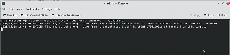

    Then next time at boot or whenever to mount the one drive disk simply run this command as a normal user
    rclone --vfs-cache-mode writes mount "onedrive": ~/OneDrive
    DualBoot W11 & Manjaro - OneDrive inaccessible from Linux 334981d1622216661t-onedrive-google-drive-linux-screenshot_20210528_164304.png

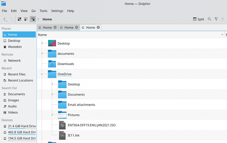

    Your OneDrive cloud disk will be mounted on onedrive in your Linux system - access just like Windows

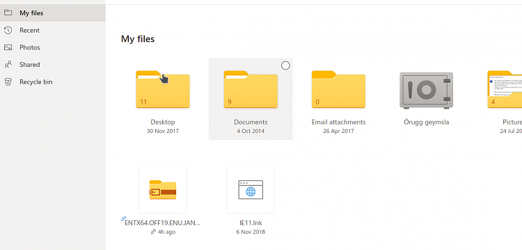

    DualBoot W11 & Manjaro - OneDrive inaccessible from Linux 334982d1622216794t-onedrive-google-drive-linux-screenshot_20210528_164531.png
    And from the browser
    DualBoot W11 & Manjaro - OneDrive inaccessible from Linux 334983d1622216940t-onedrive-google-drive-linux-screenshot_20210528_164830.png
