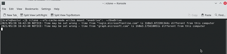

    1) Install rclone on Linux via your package manager - on arch / manjaro it's in the AUR (yay rclone)
    2) follow these instructions after installing rclone (start at step 2 in the instructions !! skip step 1 -- install via your own package manager)
    How To Mount OneDrive In Linux Using Rclone (Supports Business And Personal Accounts) - Linux Uprising Blog
    After Web browser opens -- sign in and save as book mark
    Then next time at boot or whenever to mount the one drive disk simply run this command as a normal user
    rclone --vfs-cache-mode writes mount "onedrive": ~/OneDrive
    DualBoot W11 & Manjaro - OneDrive inaccessible from Linux 334981d1622216661t-onedrive-google-drive-linux-screenshot_20210528_164304.png

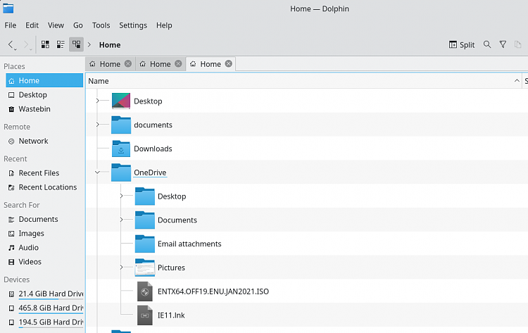

    Your OneDrive cloud disk will be mounted on onedrive in your Linux system - access just like Windows
    DualBoot W11 & Manjaro - OneDrive inaccessible from Linux 334982d1622216794t-onedrive-google-drive-linux-screenshot_20210528_164531.png

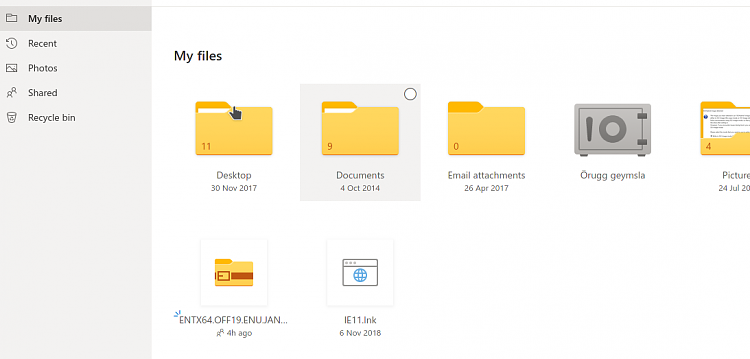

    And from the browser
    DualBoot W11 & Manjaro - OneDrive inaccessible from Linux 334983d1622216940t-onedrive-google-drive-linux-screenshot_20210528_164830.png
