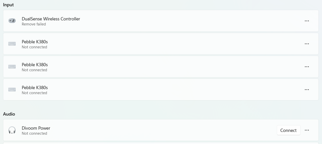

    Few things to keep in mind about the Dualsense controller:
    I use it with several devices over Bluetooth. Dualsense can automatically reconnect only to the last used Bluetooth device. If it was recently paired with device A and then paired with device B, on Power-on it will automatically connect only to device B. Device A still can connect, BUT device A should do this from its end as the controller has no menu and list of devices to choose from.
    Although Sony says this: A controller can be paired with only one device at a time. Each time you change devices you must pair the controller with the new device.
    So the issue
    Windows 11........
    In Windows, there is no button to connect to a recently paired input device‍♂️
    What that means: that means, I need to remove Dualsense from paired devices every time I want to connect it to a PC.
    Dualsense Controller is connecting to Windows, however it thinks it is an audio device, and... wr61hRvjBJsdxALTsUDlMNY3wjZYiee9ZdXqOslAM%2FhuZvKk39zYvS2l%2BiWIk9mF0Jgme2n65rb5TK9ZpcqT0FPBU%3D.png

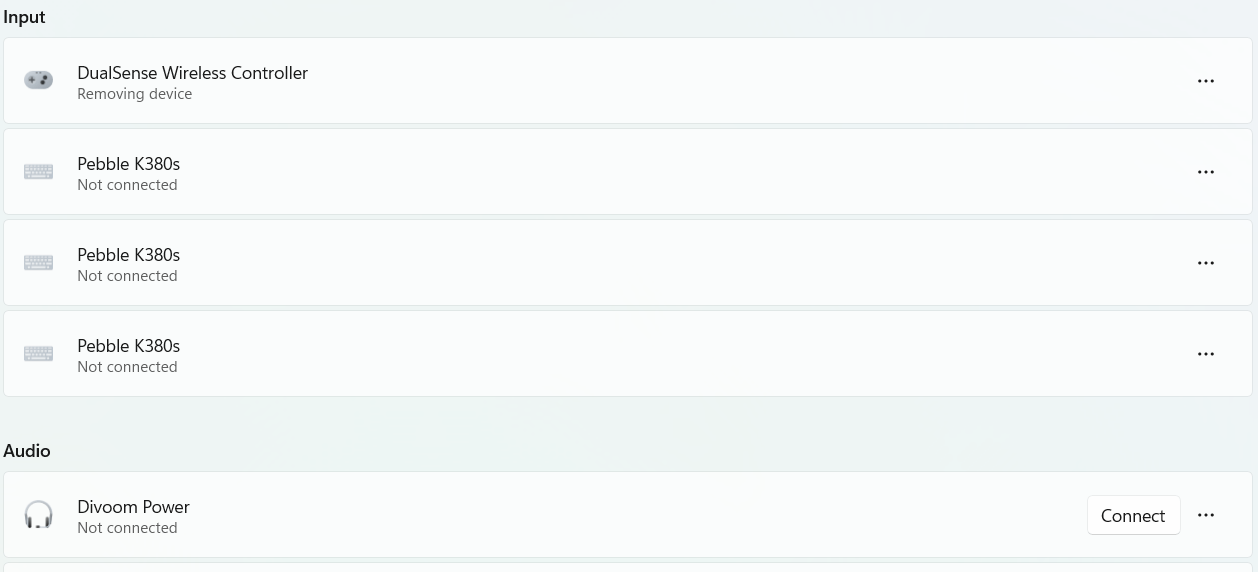

    Earlier its been removing device fine. But but out of the sudden it now failing to remove it.
    Dualsense Controller is connecting to Windows, however it thinks it is an audio device, and... bx92lzXSU5AS48%2FGqLl4HVsB%2B7vGch2V5n0wgh8n8yozTby5bBMUZYfR4sdq3UTkoXK40w0hRArEZ2b%2BPwRMqXA%3D.png
    I tried removing it from within the Control panel, Devices and printers - it does nothing after clicking Remove.
    I also deleted Dualsense from Device Manager - but it is still in the list of paired devices.
    I cannot pair it a second time - Windows Filters out devices that are already paired.
    It's a dead end. I cannot add it because it's already added and I cannot connect to it because there is no button to connect. I don't know how it was possible for Microsoft to make the system in such a way.
    Please don't suggest me to revert Windows Updates or checking if the PC is powered on or if Bluetooth enabled and If the button on Dualsense was pressed. The only reason I'm creating this post is to get Microsoft's attention to these bugs.
    However, if you know a working way to bring the controller back to work with Windows 11, let me know. (and yes I know I can use it over a USB cable, but that is not a WA I need)
