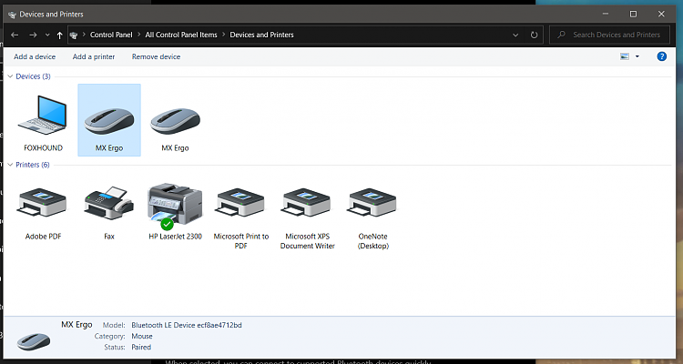

    Hey Guys,
    So I am running into a weird issue on my Lenovo Think pad T570
    Windows 10 1909 build 18363.836
    i7
    16gb of ram
    1tb crucial Nvme SSD
    Non-touch screen

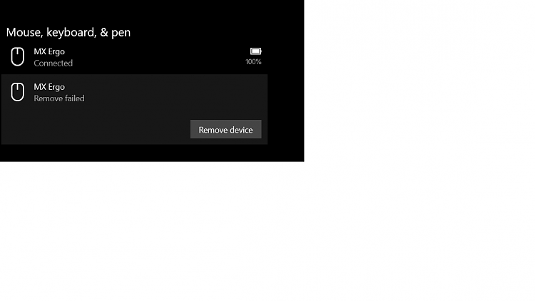

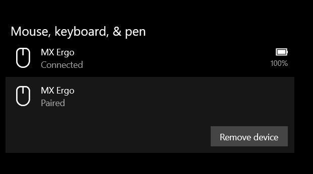

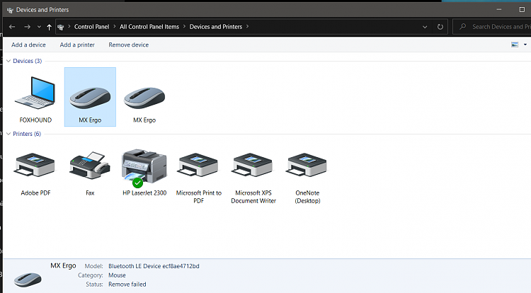

    My issue is with Bluetooth, I have a Logitech mx ergo trackball (great mouse)
    and for some reason I have 2 of them on there. One obviously works as I can use my mouse but the other says paired but I can not remove it.
    Duplicate Bluetooth Device Removal Keeps Failing 280158d1590412838t-strange-bluetooth-issue-unable-remove-device-its-duplicate-bluetooth-error-1.png
    Duplicate Bluetooth Device Removal Keeps Failing 280159d1590412886t-strange-bluetooth-issue-unable-remove-device-its-duplicate-bluetooth-error-3.png
    Duplicate Bluetooth Device Removal Keeps Failing 280160d1590412937t-strange-bluetooth-issue-unable-remove-device-its-duplicate-bluetooth-error-2.png
    Duplicate Bluetooth Device Removal Keeps Failing 280161d1590412970t-strange-bluetooth-issue-unable-remove-device-its-duplicate-bluetooth-error-4.png

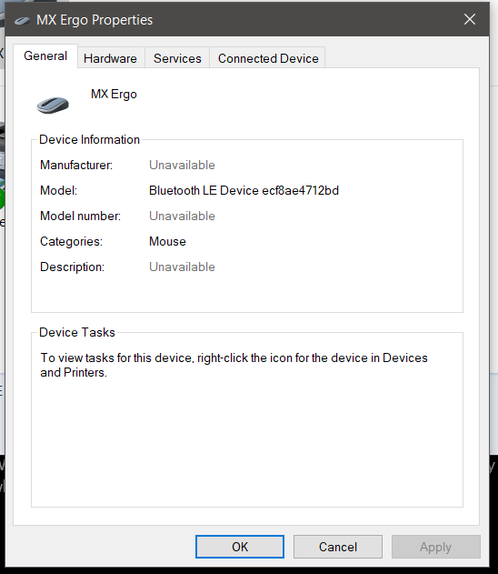

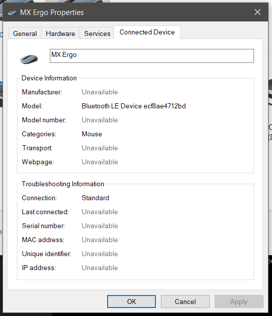

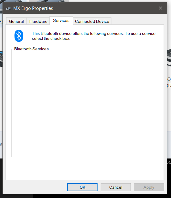

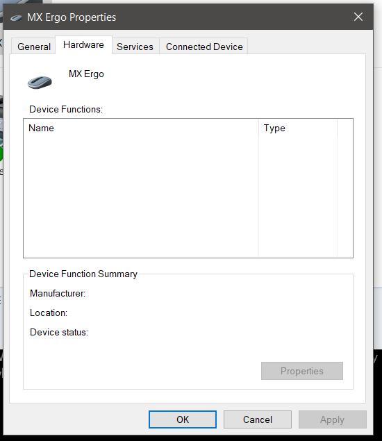

    Oddly enough too When I go into the properties of this device there is no information on anything
    Duplicate Bluetooth Device Removal Keeps Failing 167d1590413111t-strange-bluetooth-issue-unable-remove-device-its-duplicate-bluetooth-propeties-1.png
    Duplicate Bluetooth Device Removal Keeps Failing 168d1590413124t-strange-bluetooth-issue-unable-remove-device-its-duplicate-bluetooth-propeties-2.png
    Duplicate Bluetooth Device Removal Keeps Failing 169d1590413135t-strange-bluetooth-issue-unable-remove-device-its-duplicate-bluetooth-propeties-3.png
    Duplicate Bluetooth Device Removal Keeps Failing 170d1590413151t-strange-bluetooth-issue-unable-remove-device-its-duplicate-bluetooth-propeties-4.png
    I have tried un-pairing the current MX ergo that is working and trying to uninstall and removing. and before I re-paired my mouse (This is same mouse too btw) I had gone to device manager show hidden device and uninstalled it that way too. I have tried installing a newer Bluetooth driver for the T570 I tried uninstall/reinstall of the Bluetooth Drivers. So far nothing. Any other ideas? I'm stumped at this point.
