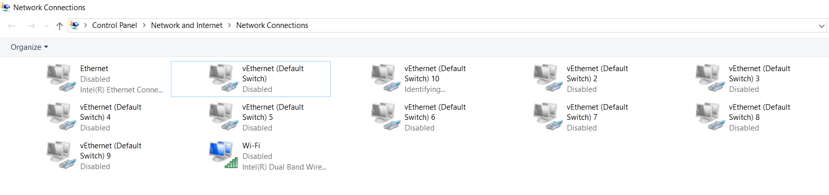

    I have two instances of a vEthernet Switch Adapter after installing a VM in Hyper V. I only have the default switch installed in Hyper V. How do I remove the greyed out adapter? Right clicking does not allow me to delete anything
    Duplicate vEthernet Switch Adapters? [​IMG]

    How to remove all the vEthernet (Default Switch) once and for all?
    As in the screenshot above, I don't know why the vEthernet (Default Switch) on my Windows 10 laptop keeps reproducing itself and auto connecting to it everytime I shut down and switch on the laptop.
    Worst is if I switch Wi-Fi networks, it auto connects to the vEthernet (Default Switch) even when i have pre-disabled it before
    Please help me find out the root cause of this problem? E.g. :
    1. Why this strange occurrence keeps happening (I suspect it is because I installed Docker?)
    2. Why I can't seem to delete the vEthernet (Default Switch) from Network Connections
    3. Why does it keep auto connecting to vEthernet (Default Switch) and how to permanently disable it?
    compski, Jun 16, 2019
