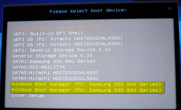

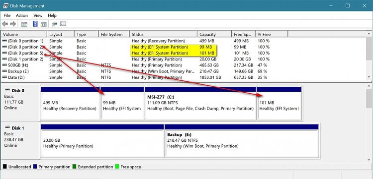

    You must have done something wrong or did not follow exactly what I posted above. If done correctly, you should see 2 EFI System partitions and both can boot into Windows. From Boot Menu, you should see 2 Windows Boot Manager

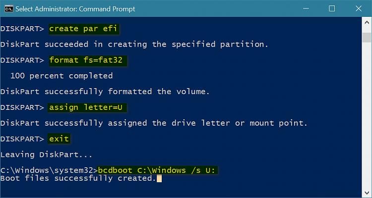

    Why did you use list volume instead of list partition ? you need to know which partition to delete.

    Try again. Use the first Windows Boot Manager to boot. Once in Windows, delete the second Windows Boot Manager.
