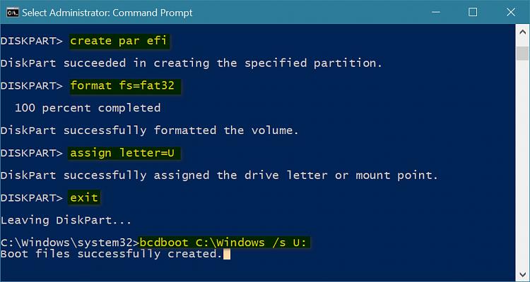

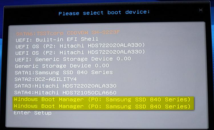

    You must have done something wrong or did not follow exactly what I posted above. If done correctly, you should see 2 EFI System partitions and both can boot into Windows. From Boot Menu, you should see 2 Windows Boot Manager
    efi and esp files missing 170571d1514918750t-how-do-i-move-esp-efi-system-partition-partition-another-p3.jpg
    Why did you use list volume instead of list partition ? you need to know which partition to delete.
    efi and esp files missing 170565d1514917843t-how-do-i-move-esp-efi-system-partition-partition-another-p2.jpg
    efi and esp files missing 170566d1514917869t-how-do-i-move-esp-efi-system-partition-partition-another-p1.jpg
    Try again. Use the first Windows Boot Manager to boot. Once in Windows, delete the second Windows Boot Manager.
    topgundcp, Dec 18, 2023
