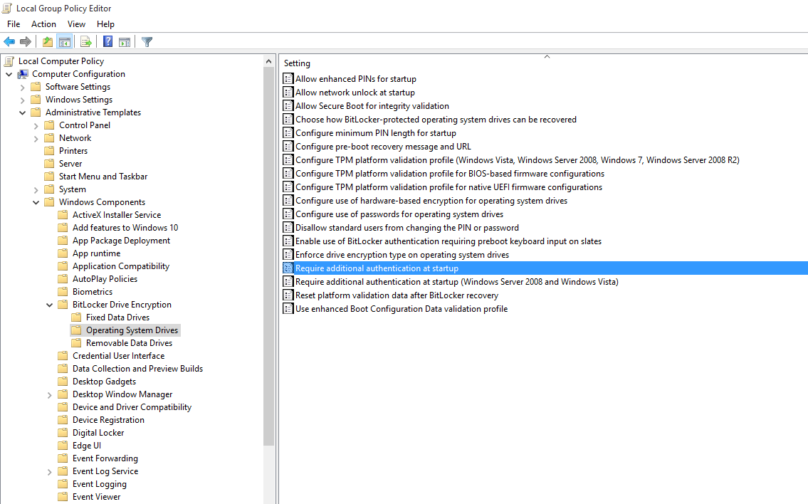

    1. Open Group Policy Editor. Do this by searching gpedt.msc in Windows Search.
    2. Navigate to Computer Configuration/Administrative Templates/Windows Components/BitLocker Drive Encryption/Operating System Drives.
    3. Double Click Require Additional Authentication at Startup.

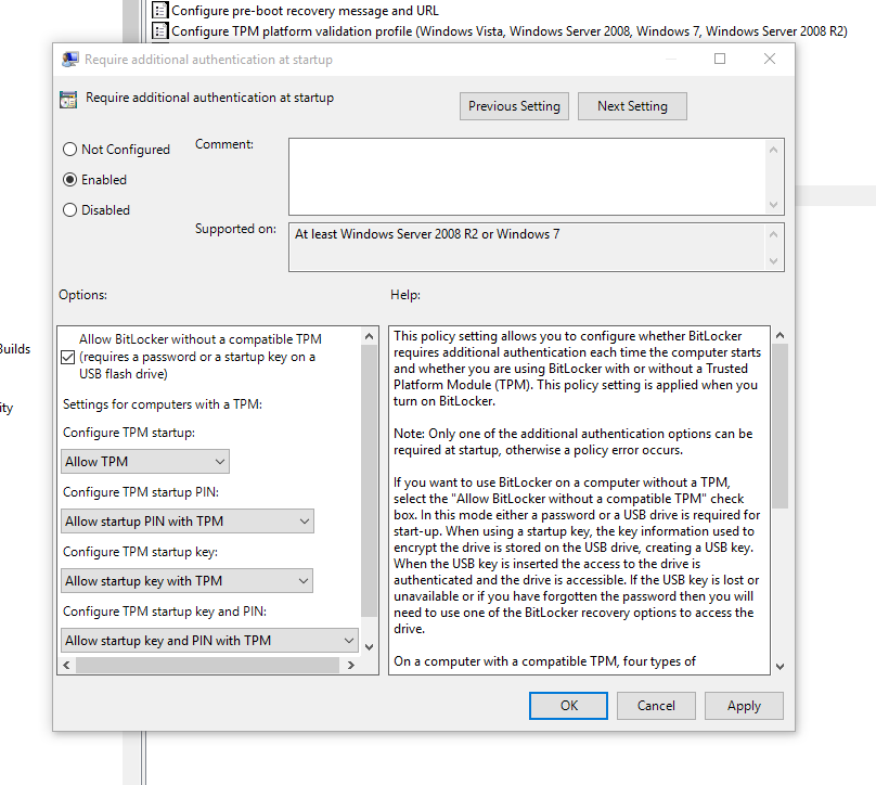

    4. Select Enable and make sure Allow BitLocker without a... is checked.

    Step 2 and 3 Reference
    Step 4 Reference
