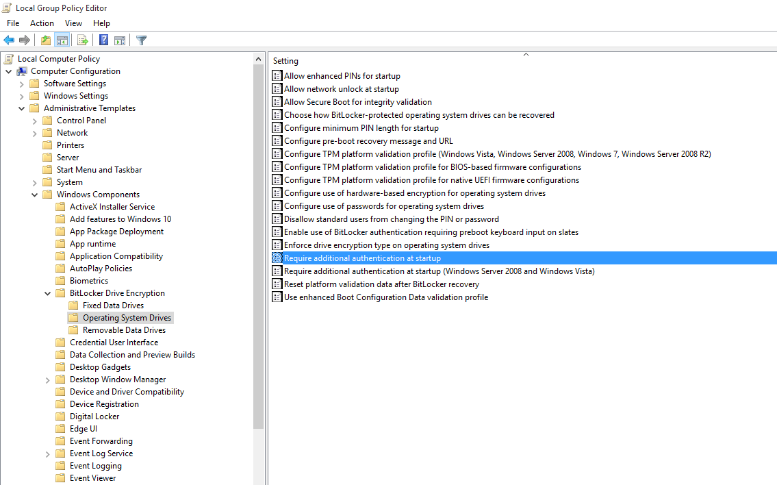

    1. Open Group Policy Editor. Do this by searching gpedt.msc in Windows Search.
    2. Navigate to Computer Configuration/Administrative Templates/Windows Components/BitLocker Drive Encryption/Operating System Drives.
    3. Double Click Require Additional Authentication at Startup.

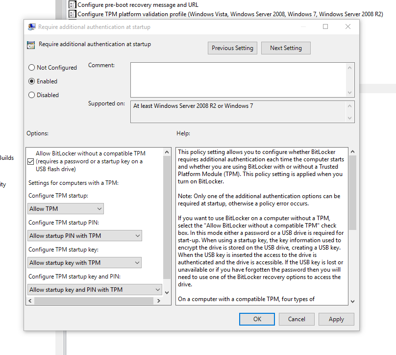

    4. Select Enable and make sure Allow BitLocker without a... is checked.

    Below are some relavent images. The first one is for Step 2 and 3. The second one is for Step 4.
    Step 2 and 3 Reference

    Step 4 Reference
