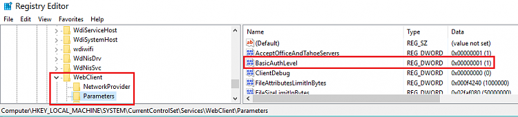

    There may be a way but you will need to work in the registry, first go over this KB article: https://Office application opens blank from Sharepoint,WebDAV or site when it is HTTP | support.microsoft.com/en-us/help
    The area you want to concentrate on is: Step 1: Configure WebDAV Redirector on the client. Skip the Windows XP and Windows Server 2003 part and go to the Windows Vista, Windows 7, and Windows 8 To enable Basic authentication on the client computer, and study the steps. You may be adding a key. BasicAuthLevel [some systems already have the key but it's set to 0 ]. Before you start create a restore point: System Restore Point - Create in Windows 10 Then complete the steps from the beginning of the Vista, 7, 8 section.
    • Here's a heads up:
    1.) I've seen that the BasicAuthLevel can exist in your registry but it's set to ( 0 ) which causes the problem you're experiencing. Then all you have to do is change the value by right clicking on it and left click on Modify then enter a 1 or 2 in the value data box.
    2.) It says to use a value of 2 for the BasicAuthLevel value but this is for secure and non secure SSL connections, I haven't found anything as to what is meant by non-secure SSL .
    I did take a look at my registry and found it's set to (1) 1 - Basic authentication enabled for SSL connections only: One (1) is what I'd go with.
    Endless WebDAV requests caused by WqlEventQuery for Win32_LogicalDisk 121205d1487129107t-what-jackrabbit-webdav-server-why-wanting-my-password-webclient.png
