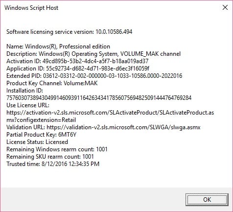

    Below image the "Slmgr.vbs /dlv" result of Un activated Machine.
    Error 0x8007232B: Unable to Activate Windows - Need Assistance 96582d1485970720t-activation-error-0x8007232b-911587.jpg
    Below image the "Slmgr.vbs /dlv" result of activated Machine.
    Error 0x8007232B: Unable to Activate Windows - Need Assistance 96583d1485970720t-activation-error-0x8007232b-911692-1-.jpg
    I also call and talk with Microsoft representative he told me that we have volume license keys and you are not allowed to upgrade to windows 10.
    It is very strange situation.
    I had upgraded to Windows 10 by two methods one was downloaded Windows10Upgrade9252.exe and installed second method was patch with Microsoft Windows Update Server.
    On Second method Windows 10 was not activated however from first method activated successfully both have Volume License Key.
    I do not understand both machine (Activated & Non Activated) have Volume License but Activated one was that who was upgrade through Microsoft tool.
    osamamansoor, May 7, 2025
