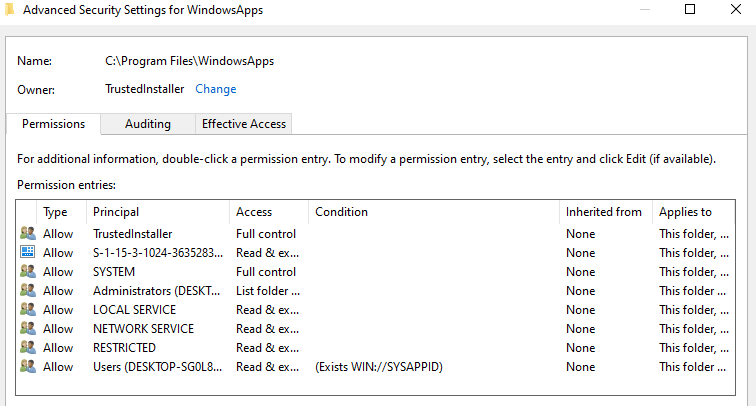

    Hello! I'm currently unable to download the XboxPC app thing required to use the gamepass on pc, I keep getting error code 0x80080005.
    I believe this was caused by my misguided meddling in the WindowsApp permissions. In order to gain access to the file for a personal project, I had to grant myself permission to it, but now, even after seemingly restoring those permissions to the default i can't seem to get it to work? What do I need to do to restore this to deafult, and get everything in working order again
    Error 0x80080005 When trying to download the Xbox PC. Need to restore WindowsApp permisions? 26757bc1-a9fa-4961-849d-4b88cabb4131?upload=true.png
    inthediggyhole, Sep 3, 2020
