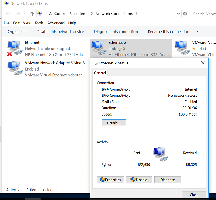

    W10 Anniversary update - can't get ethernet at 1Gbps gives 100Mbps
    Hi there
    My Lan connection seems to report 100Mbps (Ethernet) instead of 1Gbps. This is after upgrade to new W10 anniversary edition.
    Ethernet Connection Limited to 100Mbps Instead of 1Gbps 93836d1485970068t-w10-anniversary-update-cant-get-ethernet-1gbps-gives-100mbps-network.png
    My Laptop wifi can do better at 400 Mbps !!!!
    Cheers
    Jimbo
    jimbo45, Jan 17, 2025
