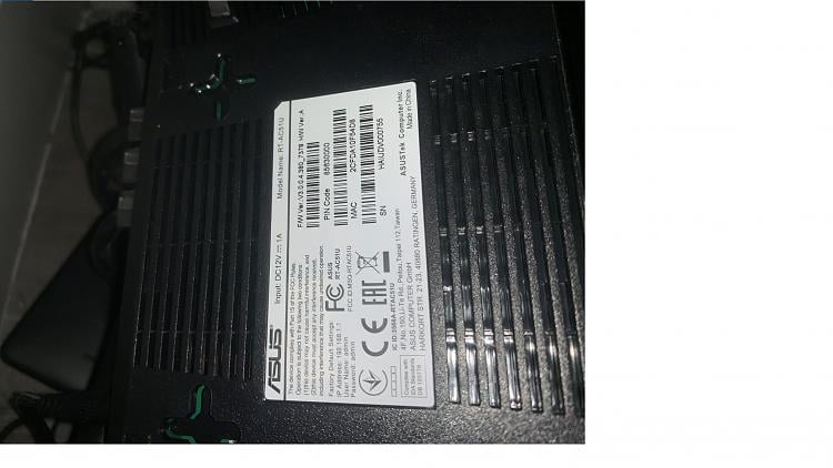

    My second Router the Ethernet is capped at 100mbps HELPPPP
    Ethernet speed capped at 100mbps when router is outputting 900? 252163d1571853150t-my-second-router-ethernet-capped-100mbps-helpppp-router.jpg
    sorry here is a picture of the Router Details

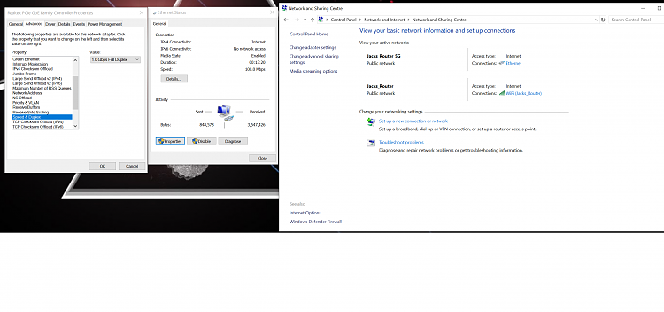

    hello, i have been looking for weeks now to try and fix this? no luck? i see people saying it may be bad wires but mine are all cat 6 i had all mine done off the same reel of wire too, now the one going from my virgin media hub into my second router, when i put that into my xbox upstairs or my laptop direct i get 257mbps thats how i know its not bad wiring. when i connect it into my new router as a access point and use that as a wireless point and to branch mulitpul Ethernets into my bedroom it then everything coming out of my second router get capped at 100mbps i dont think my lan ports are capped because it gives me a option of 1gbps any ideas? il post a photo too of what im looking at:
    Ethernet speed capped at 100mbps when router is outputting 900? 250982d1570887943t-my-second-router-ethernet-capped-100mbps-helpppp-speeds.png
    concannon, Nov 15, 2024
