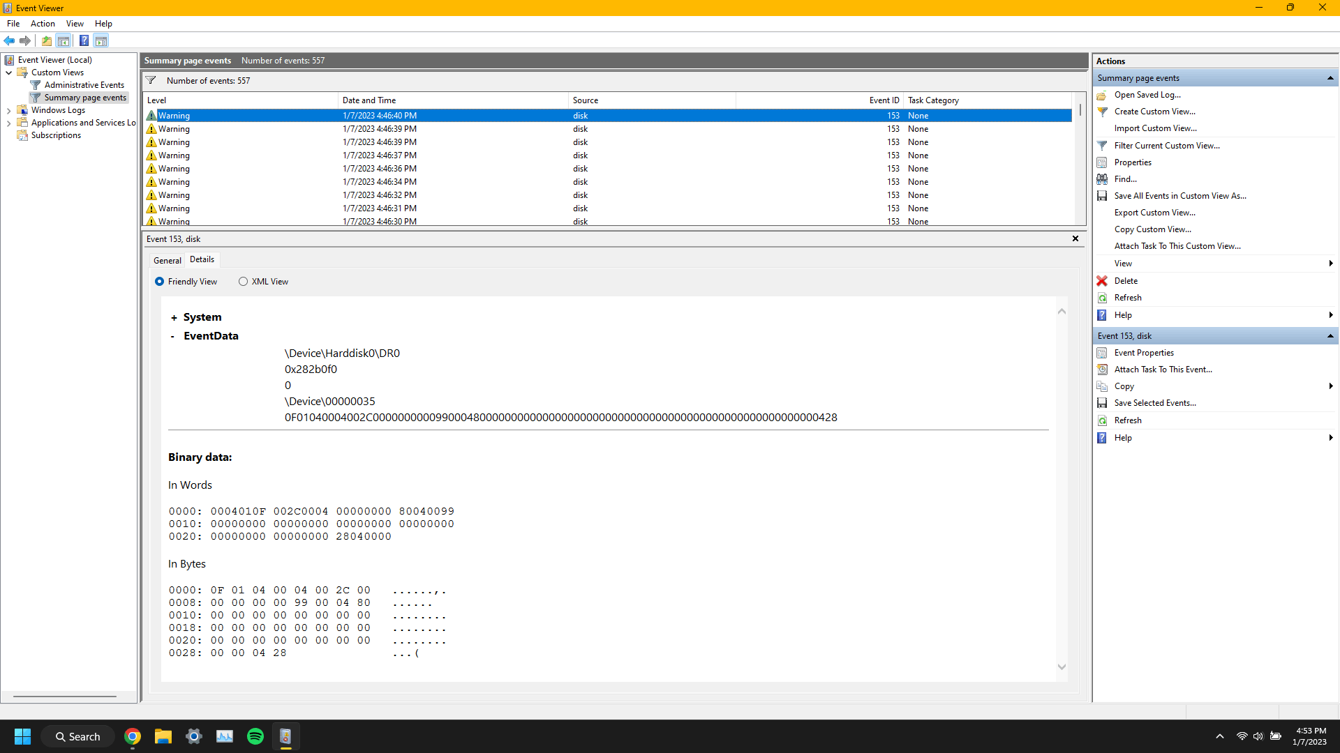

  3. how to fix event id 153?
    over the last month or so my laptop has been randomly freezing and bsod, i keep getting a disk warning with event id 153 and i've check my ssd and it doesn't seem to have anything wrong with it.
    here is a screenshot of the warning.
    Event ID 153 / 14 f28362ab-3ed0-4e8f-b833-6912e7184795?upload=true.png
    scaredboy23, Mar 2, 2025
